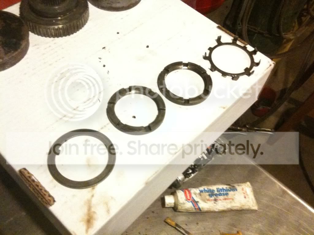

Thanks for the good info guys! The main question I had was how do I know how tight to get the first nut? And to clear up any confusion, the keyed washer I was talking about is on the far left in the pic.
flat washer / nut / claw washer / nut
I've always done the inner nut to 50# and back off 1/4 turn, spin the rotor to be sure it's smooth and seated - it shouldn't spin freely but not a ton a drag either. The outer I usually torque to 50# or so.
That is pretty much exactly how I did it. Thanks for the help guys! :bow:
