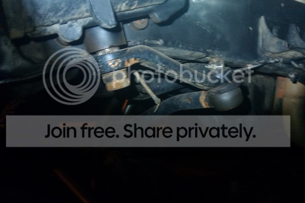

so i swaped a 2wd box for my crossover and i got a drop steering arm but the arm is cocked upwards. is that correct? anyone have pics of yours? thanks
I just went outside and snapped a pic for you. This is one that came from ORD.
It's dark and raining. Here is a crappy pic. Hope this helps.

yea mine looks like yours. i didnt know if it was suposed to be cockeu up like it is but it seems they are all like that. anyone know where i can get a nut for the bottom of the PS box?
