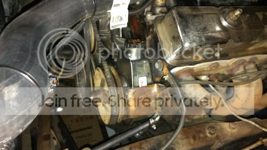

Are you using the rear bracket on the pump? Is it ok to remove the bolt in the back of the pump to mount it up?
Any pictures of your setups would also be a big help.

The tube IS the breather. One side is connected to the top, I've got a ziptie holding one loop in the tube to help stop spillage, and the other end secured/whistling Dixie. That's all that's needed, just a breather for the fluid fluctuation in the reservoir. Sorry, I don't know about the mount, I'm running serp stuff.
(without the loop, it spills a tiny bit on super steep stuff)
