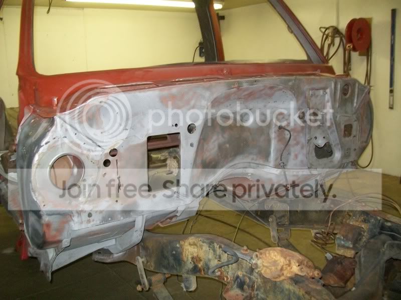

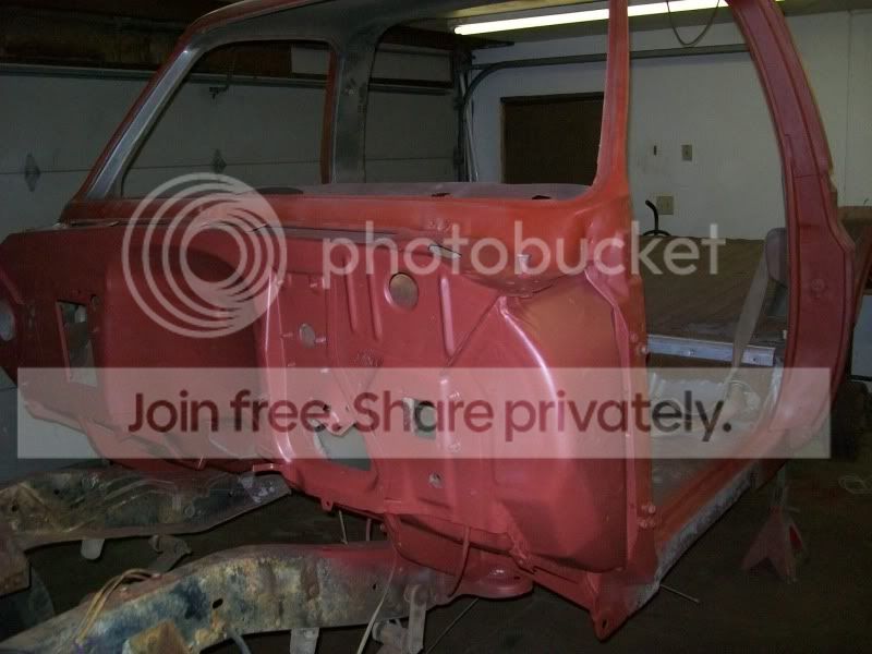

12 Hours hours of sand blasting has really paid off, the shell is clean.
The frame will be seperated from the shell before I blast that.
Firewall needs patchwork too.
Firewall epoxied DP 50.
Time to dust off the sheet metal.

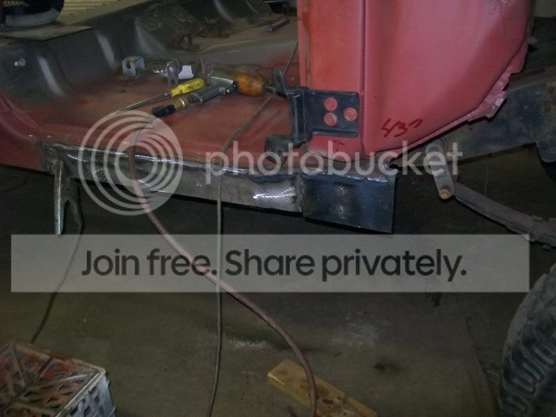

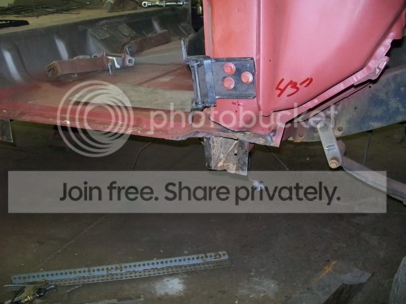

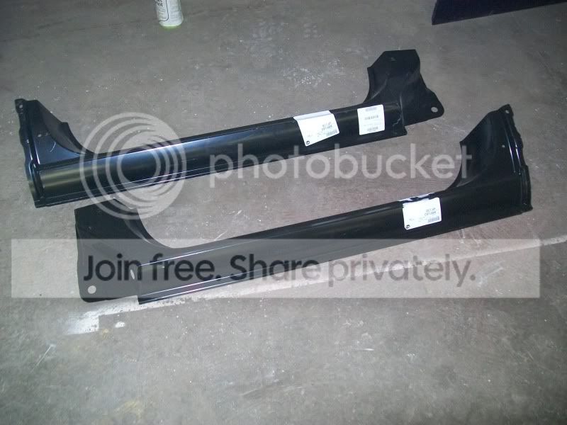

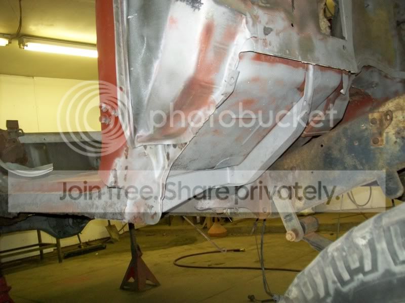

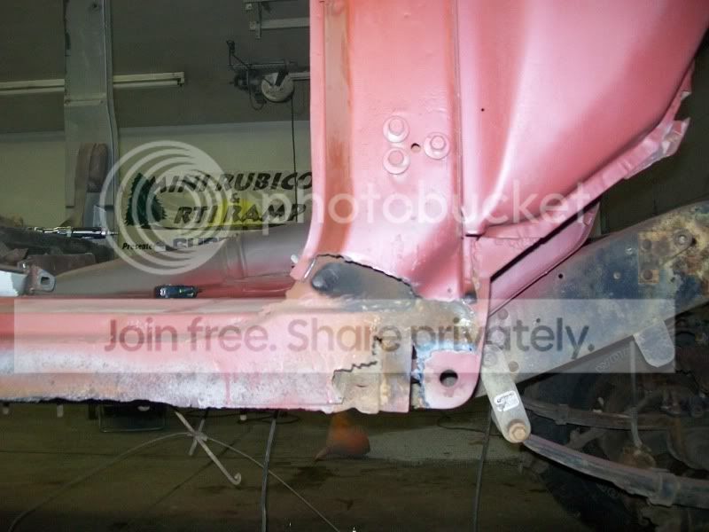

I purchased Outer rockers from Keystone, the inner I'm building from 16 GA sheet metal.
I made reference measurements before any cutting was made.
The inner rocker's patched, I sandblasted and epoxied the floor support.
The inner rockers is roughed in...

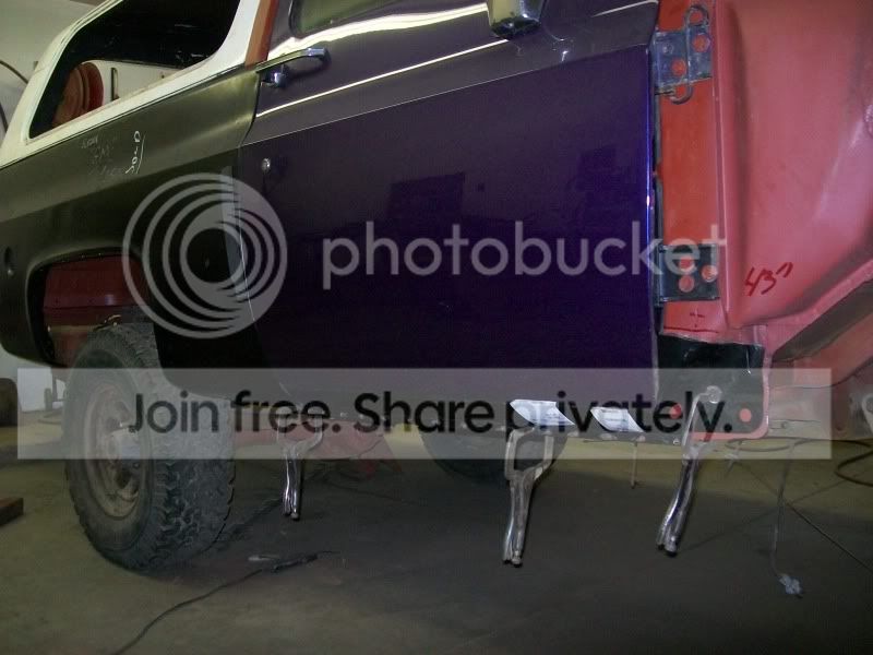

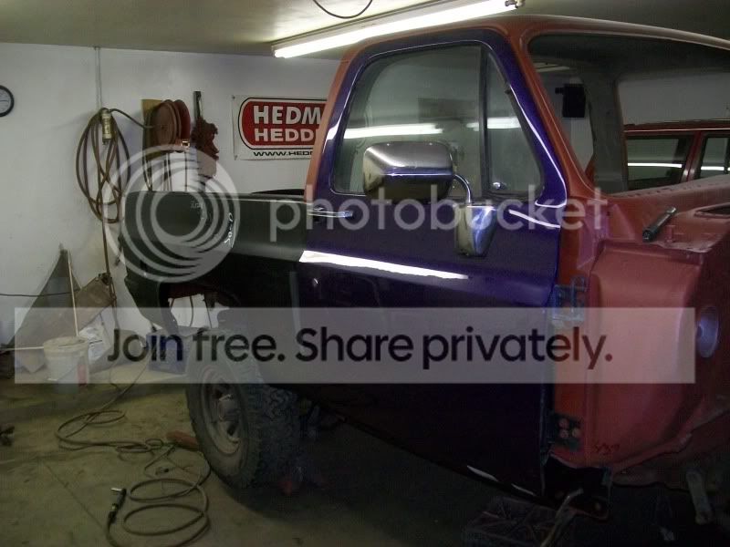

Now we need the mount the quarter, door, install a weatherstrip before I fit the new outer rocker.
I blasted and epoxied the orginal hardware, mounted/lined-up the quarter and the door. Now it's time to do the same repairs to the driver side.

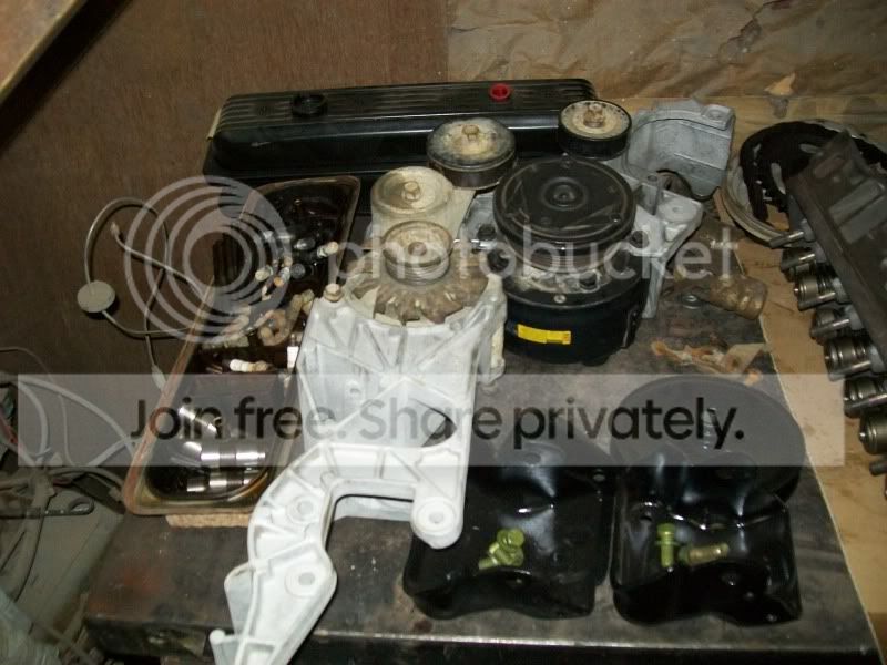

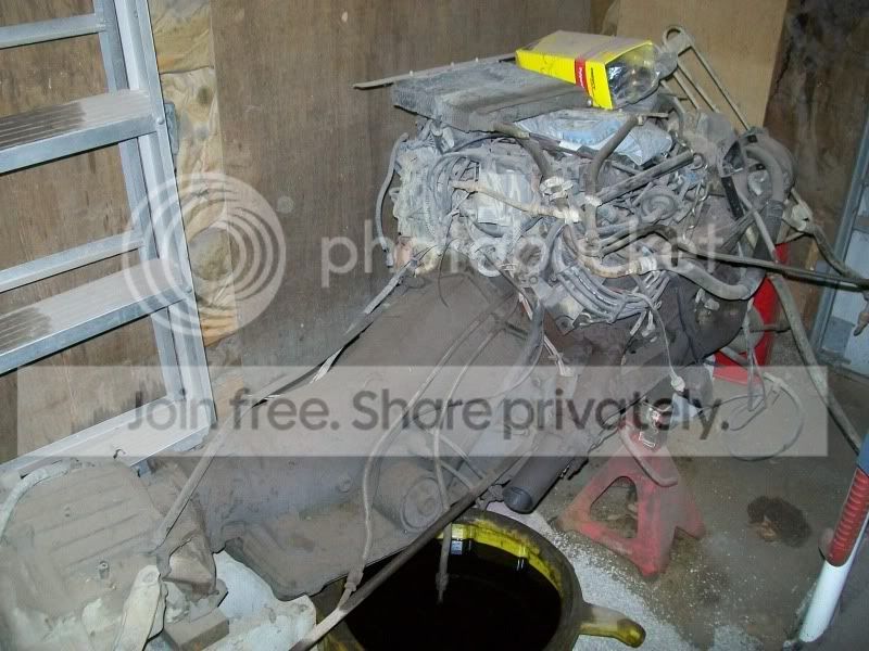

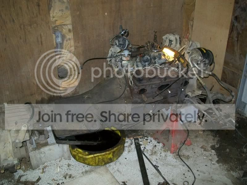

Here's the drivetrain. From Emmetology's 90' K5, 350/700r/241.
Looks like poo poo! :eek1:

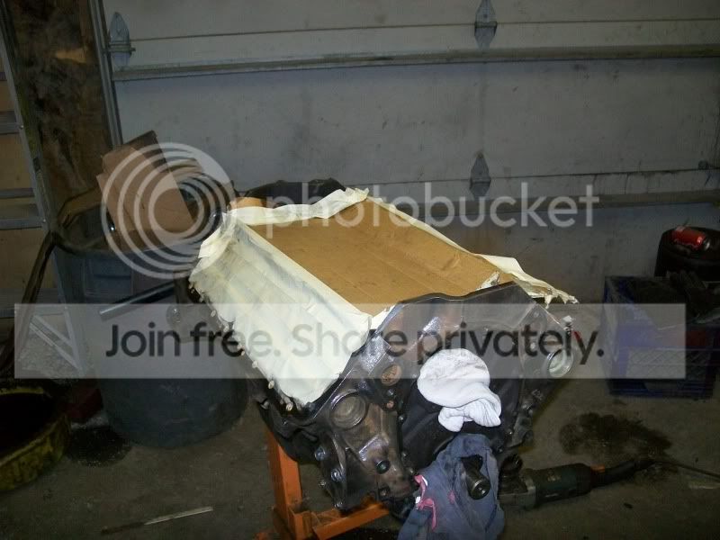

Prepping the block for paint.
Blasted and painted parts ready for install.

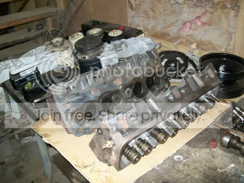

Clark Auto did the heads, $195 for a valve job.

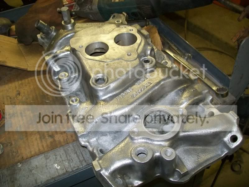

Polishing a stock TBI intake.

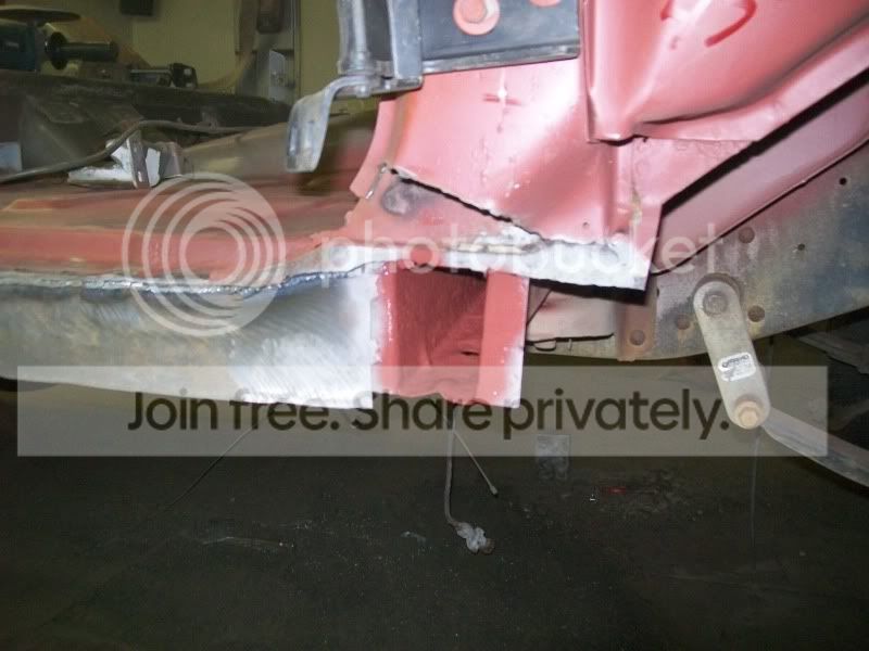

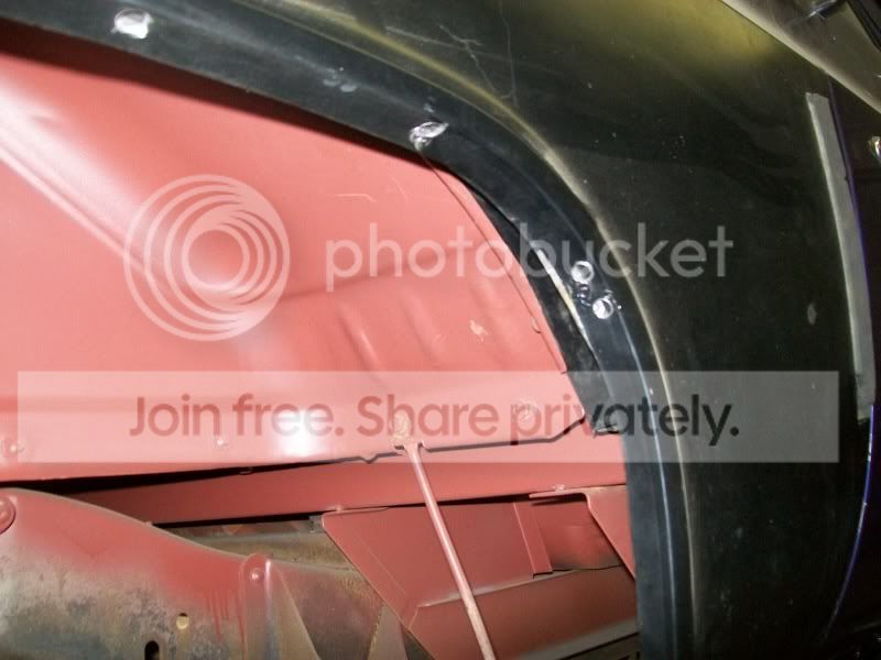

Right side's almost ready for welding..I like to mount and line-up every body panel before welding.
I cut the spot welds, the quarter looked "sucked-in"...
