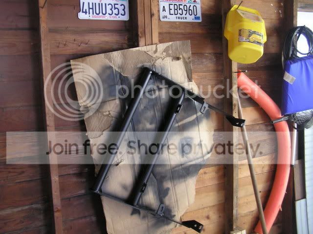

well i just got the paint some rattle cans of "Low Gloss" Tractor paint.:D Its a little tougher than krylon.
Its gonna get painted this weekend
well its all painted it gets bolted back in tomorrow
