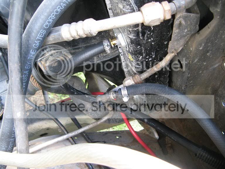

My truck was originally ran from trans to rad to aux cooler and then back to trans. I run 175* all day long, I just wanted/needed to upgrade my cooler and lines. I left the configuration the way it was, since its been working this long.
B&M instructions say to run it this way as well, no mention of climate. They go from tranny to rad to aux cooler.

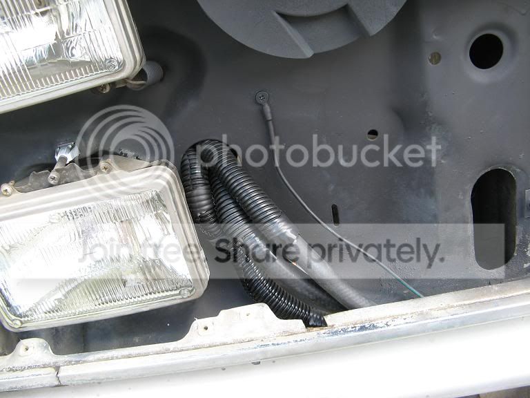

LoL...yea. well as you can see in my pic. I went with plate style. Mainly for the durability and ease of installation. No more zipties thru the radiator for me.
