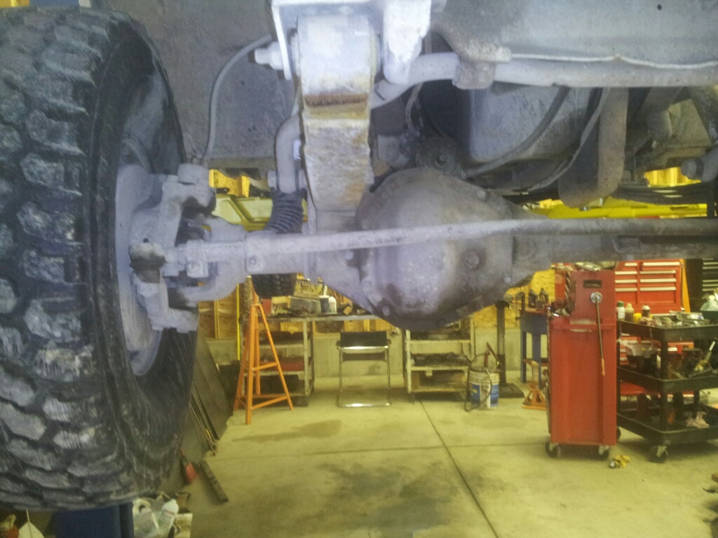

I have the chance to buy the axles out of a CUCV. The guy wants $1600 for the pair. I really want to switch to 4.56 gears eventually anyway so this seems like exactly what I am looking for.

fyi that tie rod is bent up and will need replaced. so there goes a few bucks off the price he wants .
