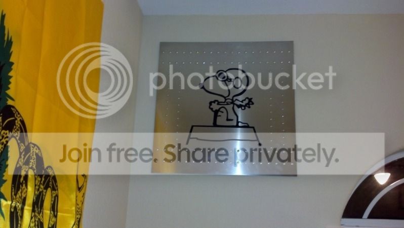

My project that I just finished was just decorative. When my crew chief and I put the nose art on our airplane, we made two snoopys but only used one. I had the extra one sitting around for a while and was just going to put it on a piece of aluminum and hang it in my office, but decided to throw some rivets at it to make it look more like an aircraft panel. Here's the finished result.
Wait till you have to install dozens of rivets in a part that has a 1/2 or less height pocket down in a 5" deep machined cavity and the heads are on the inside of said pocket. There it no tool for such a task. Thats where custom machined rivet bucking bars are created and the task still is a raging pain in the ass to get done and they still have to maintain flight tolerances and have to look correct.
I can tell you it SUCKS big time but HAS to be done one way or another. There is no telling the boss we can't launch this satelite cause it's impossible to install the rivets. God how I wish some of these dumbass engineers had to do hands on work on the assembly floor and know what we have to deal with. On a cad/cam system everything seems easy. Actually doing it in the real world is a whole different thing. Rivet job looks nice and the piece looks cool as well. Props buddy, nice work. :waytogo:
