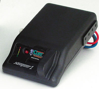

By the way any recomendations on a good afordable contoler
Most auto parts stores have cheap ones. I got a good one from a Heavy truck center.

allrite so besides a controler is there anything else i will need?
Like i said in a earlier post i dont know much about this stuff
The instructions with the controller will tell you more. My tow rig is a 03 sierra, so all i had to do was plug it in. You have to see if the wire from the controller to the trailer conector is still there / in good shape. and the wire from the brake pedal. Other than that It's simple.
