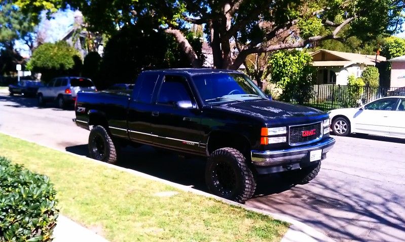

Quick pic :)
Clearly, an 8.1L conversion if that is what is in there.
Badge and z71 emblem show that it started life as a 1/2 ton, 6 lug still?
You need a stronger rear axle than the 10 bolt, hope its a 14sf at least with all that weight!
If its got a SF, or has a FF swapped in....you'll probably do ok. See what rear springs are in there too, 1/2 ton ones wont' really like that weight.
Bumper pull trailer?
GOOD weight distribution / sway control setup will be a lifesaver.
Overall, if most of the truck has been upgraded to 3/4 ton status and beyond, you'll be fine.
if not, you will quickly find the weaker, 1/2 ton links in the setup.

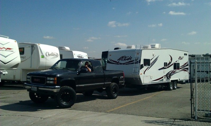

Lol ya its a swap of course. It does have a sf in the back, rear springs I'm not sure what the procomp lift kits come with if its a 2" leaf and 4" block... But its a 6" lift. I've read that bags help... I guess we'll have to see how it does LOL..
Thanks for the response :-)
Bags or not, i'd throw some 3/4 or 1 ton springs in there.
Can't be that expensive, and will help a lot.
Sweet truck, how about some pics of the 8.1 when you get home from your trip.
