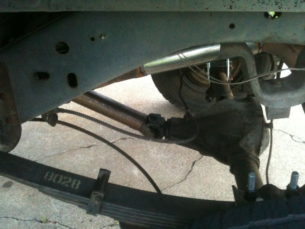

Here is what it looks like with the 2.5 degree shims. As for the steel shims i was asking about i would not weld them on while the leafs were bolted up. Just tack them and then lower the axle and weld them. I havent tighetened the u bolts yet. I want to get this angle figured out, so i can measure for the drivelines to be lengthened.
yeah, that pinion definitely needs to come up. Do you have a cv shaft on there? If so you're going to want to point the pinion pretty much straight at the output on the transfer case. If you do have a cv, put an angle finder on the driveshaft and figure out how many degrees you need to go up to get the pinion set. Then add 2.5* to that to account for the shim that's already there. I assume you're gonna need about ~6-8* to correct that.
Are your wheels centered in the wheel well? If not it's possible you put the springs in backwards. I know some trucks have springs with the center pin offset, that could be adding to your problem.
I still wouldn't recommend welding anything to the spring pack or the spring perches. If you wanted to go through that you may as well cut the perches off and rotate the axle to where it needs to be and reweld.
