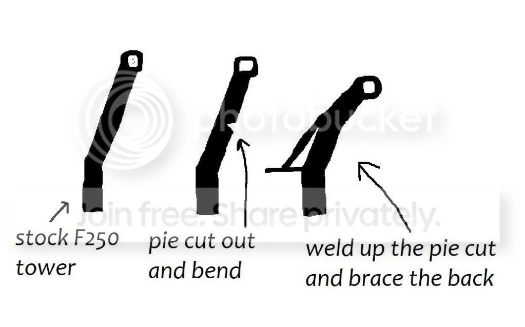

they will be on a 79 k10 with 52's in the front, i was thinking of modifying my f250 shock towers to lean out alittle more so they were closer to being straight up but if they are suppose to be 15 degrees off i might leave them alone. and yea i was goin to mount them on the top of the axle by the inner c as well
here is what i was goin to try to do, bare with me im kinda rusty on paint lol
what do you guys think
The upper mount wont really matter, that one is just modified for clearance..the lower one is the one thats give the angle, just imagine how the suspension works and go from there.
they don't need to be 15* from verticle, they work pretty much just as efficient at 15* as they do straight up.
I'm sorry, and am in no way making fun of your paint skills, but does the far right picture look like someone with a stick up their butt?:D:D
