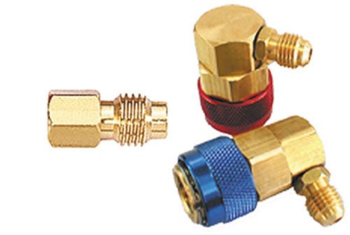

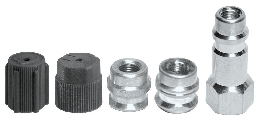

I found some old threads on this, but nothing within the last 10 years or so. Anyone know of a true conversion kit to do this right? I'm willing to pay (within reason), but would like to do it myself. My understanding is that there are minimal adapter kits available, but that's not the same as having the system made to work right with the R134 in the first place. I'm pretty clueless about AC...
My system current functions but must have a leak since it stopped working after I had it charged last time - it took a few years to fully stop working. I'd like to get it working and make it so I can charge it myself in the future.

Lots of detail and sounds like the guy had great luck just evacuating the system, converting the ports and replacing some seals.
