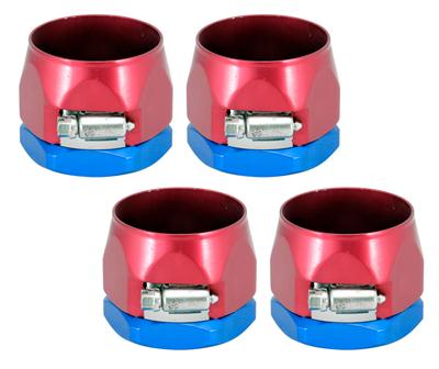

Now to look into some plumbing options. I'm thinking about running some summit steel braided hose for this plumbing project and trying these hose clamps on my brand new old school black rubber radiator hoses. I need a little *bling* going on in my engine compartment to distract the eye from the old oil everywhere.
http://www.summitracing.com/parts/SPE-4161/?rtype=10
