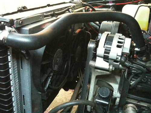

I bought an oversized radiator and modified the brackets to make it work. I also got the Derale dual electric fans with the aluminum shroud mounted to it. It took me 30 minutes to modify the original mounts; I formed a new lip to extend the brackets, then drilled and plug welded them to the originals. Shot em with black paint, looks completely stock.

Here's my setup:

Yo = that's looks flippin awesome! Its so clean too. Compared to the ugly ratsnest I got going on under my hood !is there a writeup on that? How much HP did you gain eliminating the stock fan?
