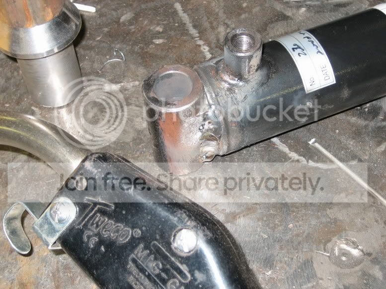

Well, I'm about 90% done with mounting the ram/plumbing etc. Still have to pretty up and finish grind the mounting tabs and paint etc. On to the pictures-
First thing on order was taking the ram apart and chucking it in the lathe to cut the weld...
Remove the end and weld back on 90* apart-
Mount Ram and plumb lines-
And this is my temporary fluid resivoir extender thingy-
The mounting tabs are made from 3/8x2" flat bar...Jesse's old shackles. If I had had some 1/4" material, I would have used that. The 3/8 material looks alittle goofy. Everything works fine...except I have to be at like 2000rpms to get any assist out of the stock pump. At 2k rpms, I can now turn lock to lock on concrete, where I couldn't before. Below 2k theres nothing. I think the flow/pressure mods are pretty much required with a stock pump. I have a brand new spare that I'm gonna mod and install tommorrow. The one I have on there now, is less than a year old, but has some serious hard abuse on it. If that doesn't work, I guess it's time to start researching aftermarket pumps. :crazy:
