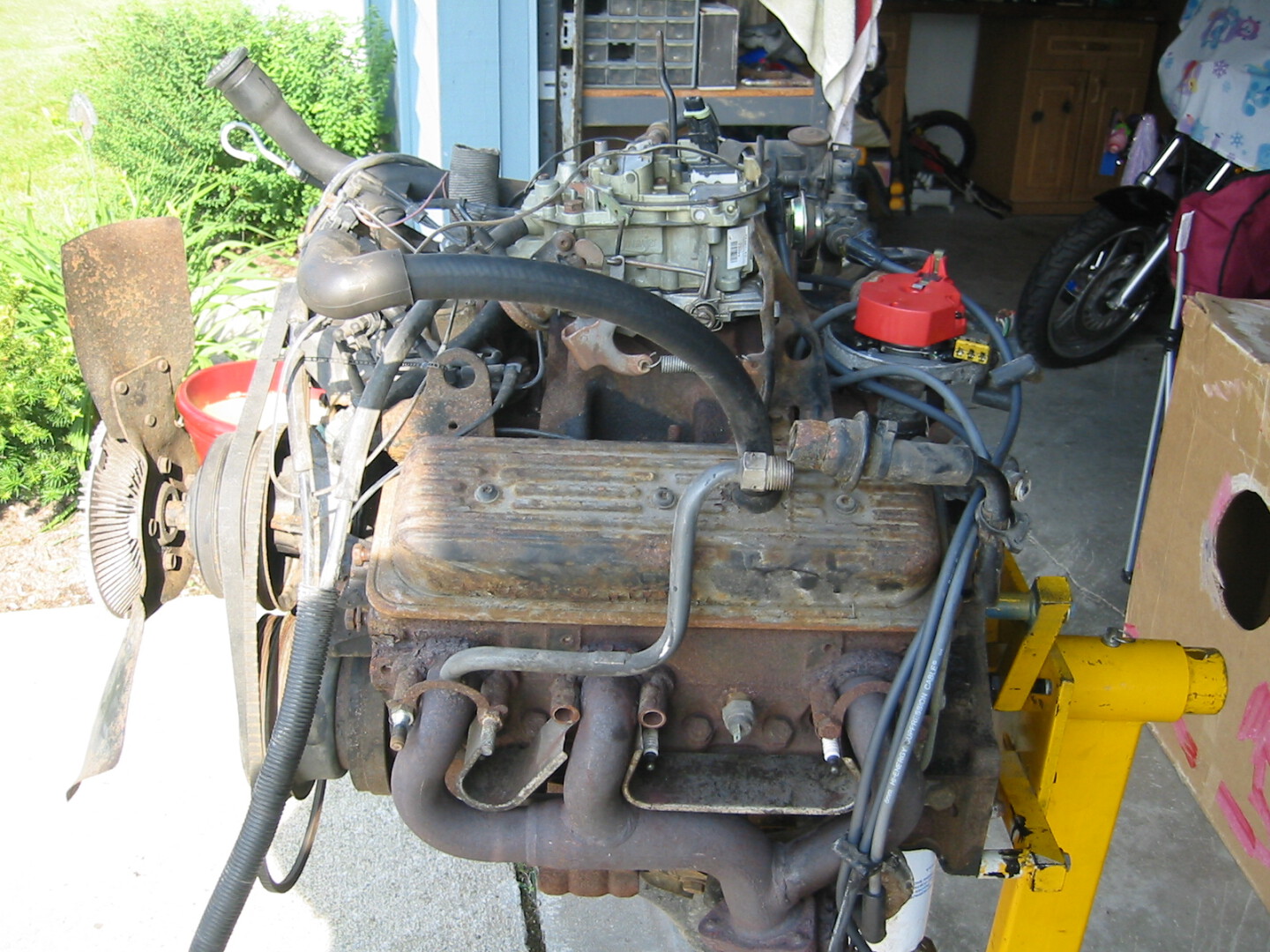

This can't be that hard. What does the factory use on performance vehicles. I wonder what's on my '04 GTO, I never looked. What do Corvettes use? My '86 Chevy C10 with the 4.3L v6, it has header like manifolds that came from the factory, that is they are mandrel bent tubes, not cast iron, med length. They look rusty, they are rusty, but in all the years, they have not rusted thru and are still quiet. There's really no sign of them rusting out, the surface is just rusty but hasn't really changed in years. These things are exposed to massive salt spray too, they are on my DD, and I drive 3-4 hours one way every other week to another state. Sometimes the whole way it's snowing slightly and the road is nothing but a salt spray booth.
These are OEM:
Those are OEM.
