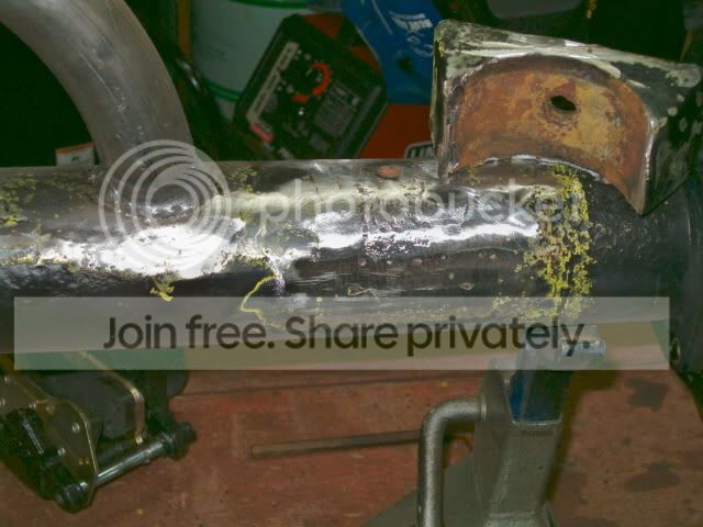

Nice, I plan on reusing mine also...although not as clean of a cut as a plasma, I got them off:
