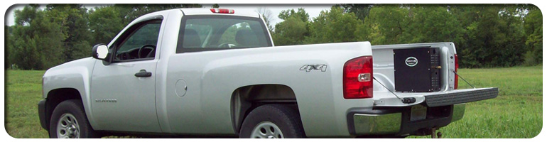

I have wanted one of these for a while, I also know someone making a couple but its a little way off before his couplers and parts are made and I could really use it. Right now I carry nitrogen for business use, and while its convenient to use its not cheap. Last month I went through 4 tanks.
here is the stats on the 12 volt one.
http://www.12-voltair.com/store/ind...s_id=1&zenid=e41928f87c0edfffe80918721f46914f
POWER SOURCE- 12-Volt Battery (1 good battery of 120+ minutes of reserve or 2 batteries)
AMP DRAW- 80 amps*
DUTY CYCLE- 80%- 50 minutes of runtime out of an hour @ Temps under 90 Degrees F.
MAX PSI- 150 psi
CFM** @ 50 psi 12 cfm
CFM** @ 100 psi 6 cfm

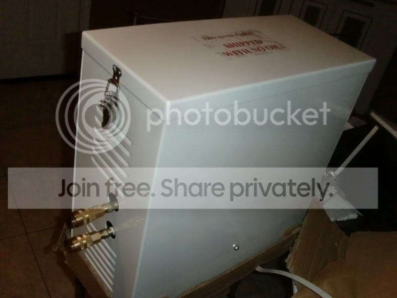

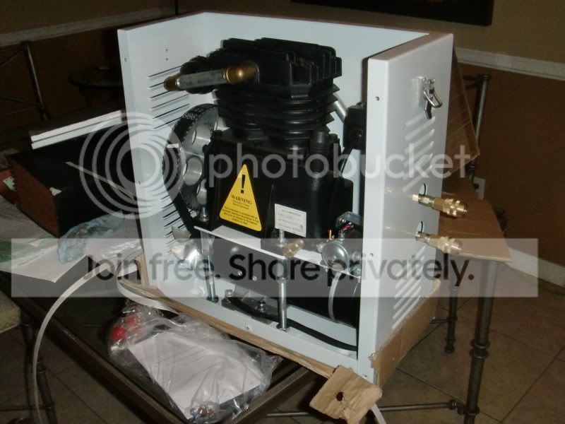

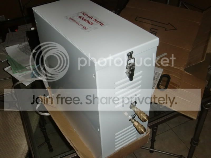

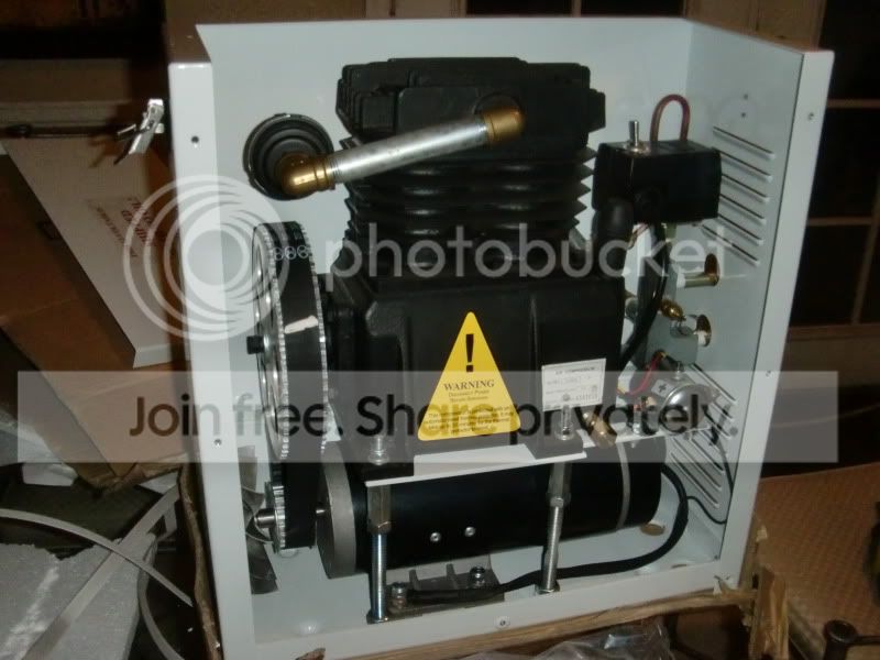

Happy birthday to me, well a few weeks early but whateva
:D
So far have only used it to try to break my table and screwed in the 2 ports im lost on where I actually want to mount this thing.
I really do not want to have to climb in the bed to the front, I do not want it near the back and I do not want to give up room in my side doors
Dangit.
Currently trying to see what I need to do to wire a second battery the correct way.
