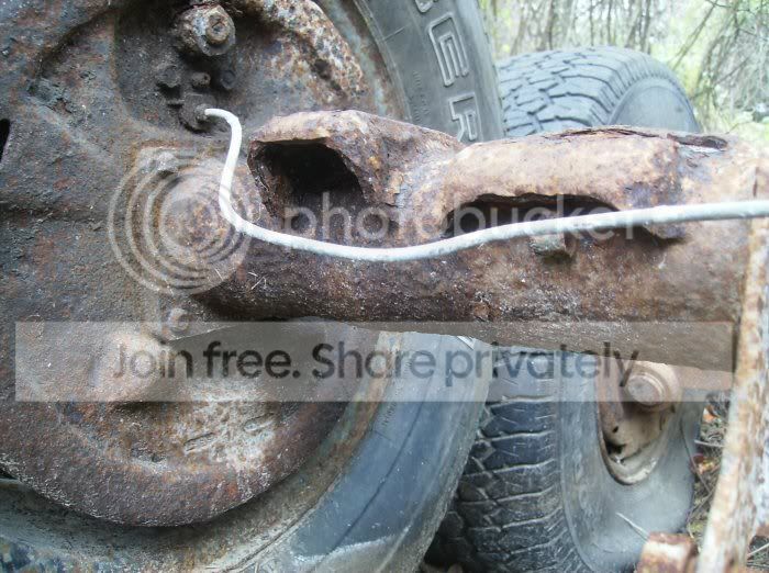

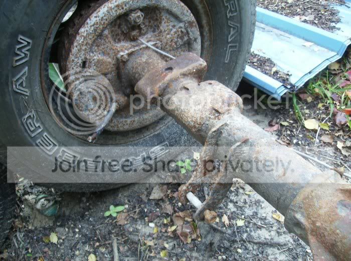

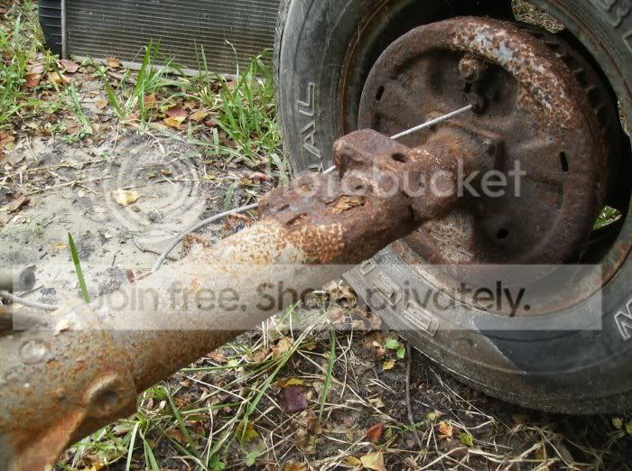

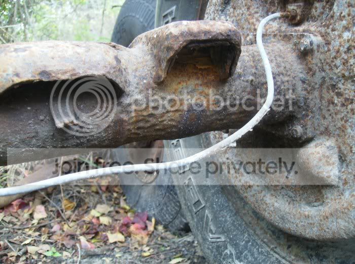

I'm getting a new to me rearend this week. I figure any axle can be cleaned up but what would it take to clean this axle up?
Passenger side:
Drivers side:

Truck was used to put boats in the water at the coast....salt water+iron...no bueno.

Is that a 10 bolt?
torch it up into pieces, and start with a different one.
edit- i'd say scrap it, but i dont think you would get much

Thats serious corrosion, I would check the spring mounts better, and even the axle tubes where the u bolts go. I think the metal may be thin enough to collapse from torqueing the u bolts.
sand blasting is going to be the only way with that bad boy.
I have seen axles that bad before and it seem like they look really bad but none that I have seen used have had any problems
Definitely needs new spring mounts, you can see where it looks like one has collapsed already.

If you are disassembling the axle, acid dipping will get rid of all that rust, then you can see what a POS the axle is. Dump it, I seriously think that the tubes will be weak in the u bolt area. For sh!ts and giggles, drill a small hole in the worst areas to see what thickness you have left. If you decide to keep running it, you could weld it back up.
Sorry dude, that ones a goner! Your going to hate that thing by the time you get all the rust down to a use-able level. Even if it was free.
:doah:It's 50/50 whether it would be worth it or not. If nothing else I'll scrap it . It's not a free axle but still cheaper than a FF 14 bolt even with all the work.

I've torched a few SF axles up for scrap at the junkyard--the tubes are at least 3/8" thick,if not 1/2",so though it might appear to be "thin",its probably still got some meat left under all that rust...I wouldn't waste much time making this axle look good,just toss it in after a quickie wire brushing and rustoleum spray job and run it till it croaks..
