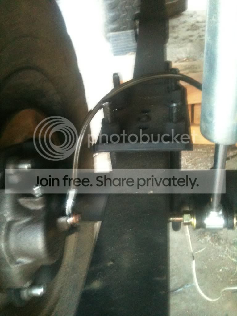

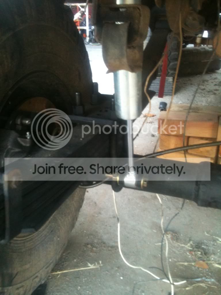

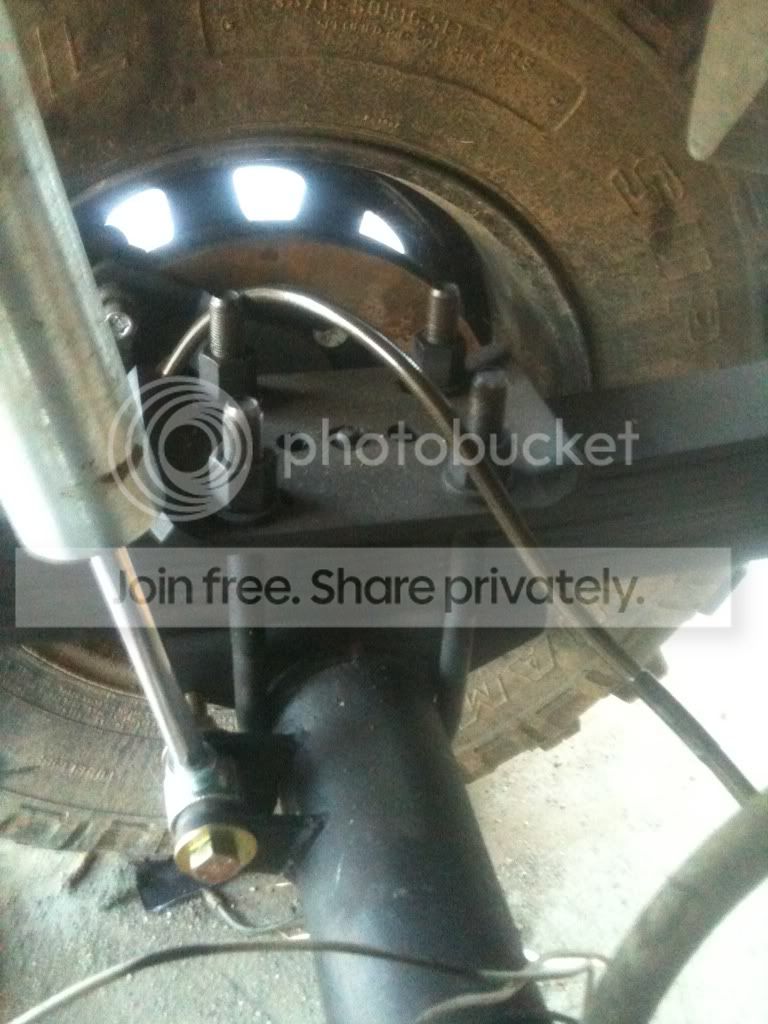

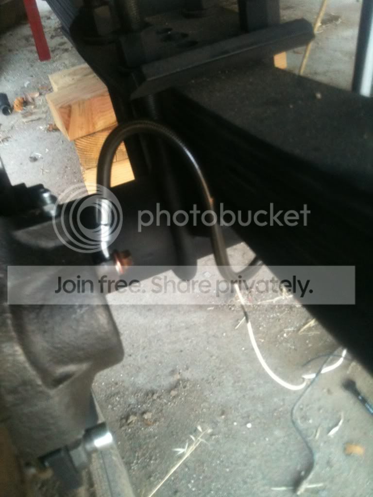

My new ord lines on my rear disk setup.
Should I go over the leaf pack and down which makes a cleaner setup at the caliper, or u der the springs and come and loop up to the caliper,
I like going under the leafs but don't like how it flips around bcuz the calipers have those little banjo bolt shields cast in??? What do I doooo
cross posted to garage for more advice before i go home and start filling up the lines.
TIA
I would go OVER the spring plate and use a clip to attach the line to the top of one of the U-bolts to keep it from rubbing.
