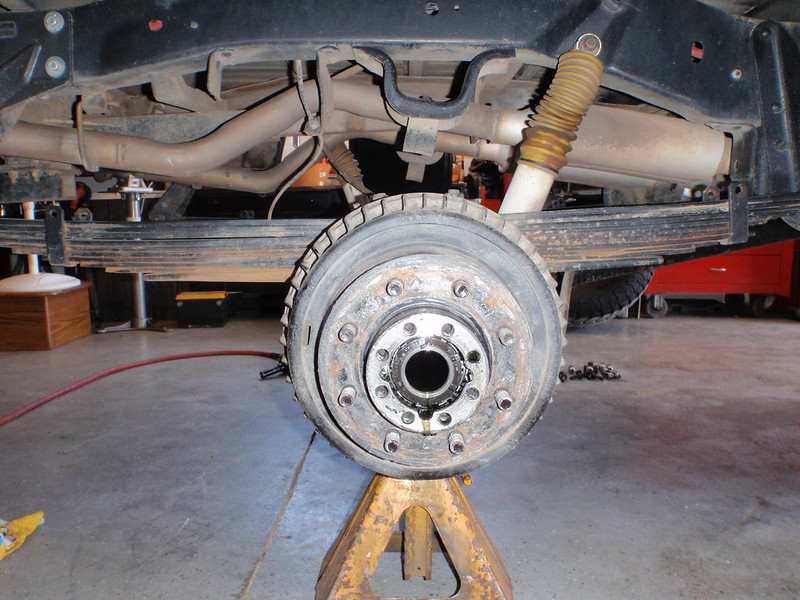

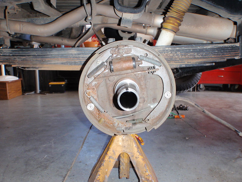

Off with the little 11”s

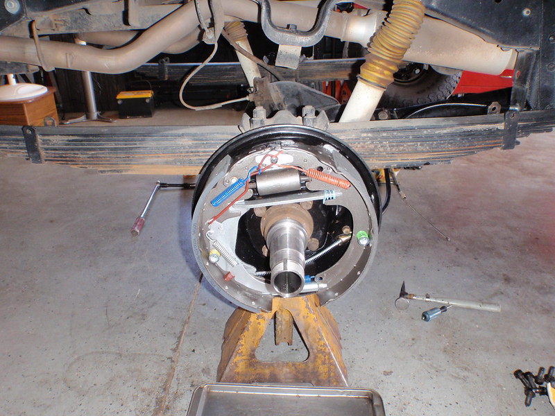

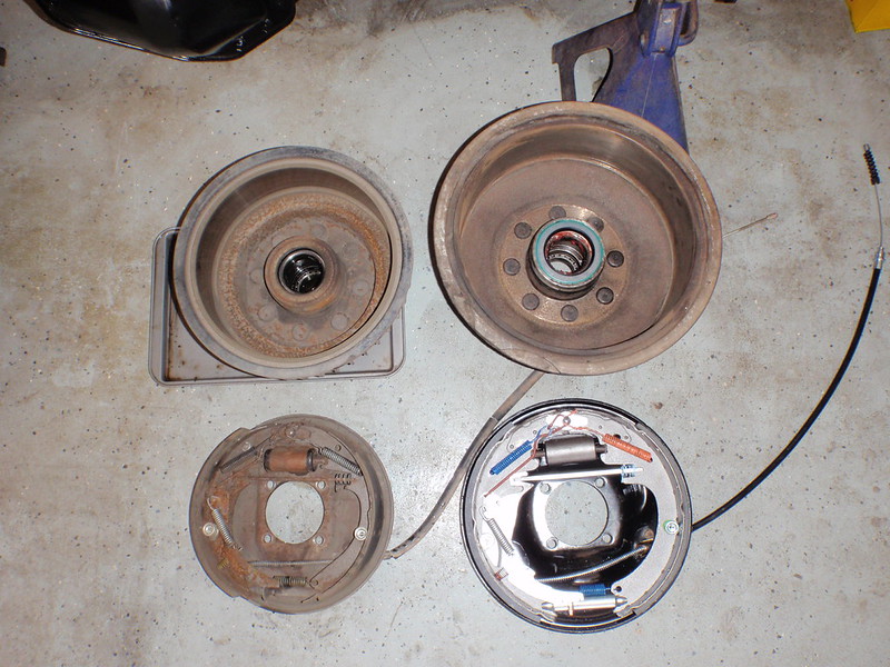

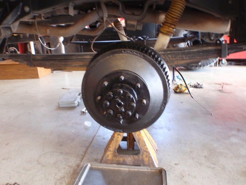

Check out the difference when the 11’s are laid next to the 13’s. I installed the new shoes, hardware and e-brake cable on the 13” backing plates last night so it make the job quick and easy today. That 13” drum is a heavy mofo!

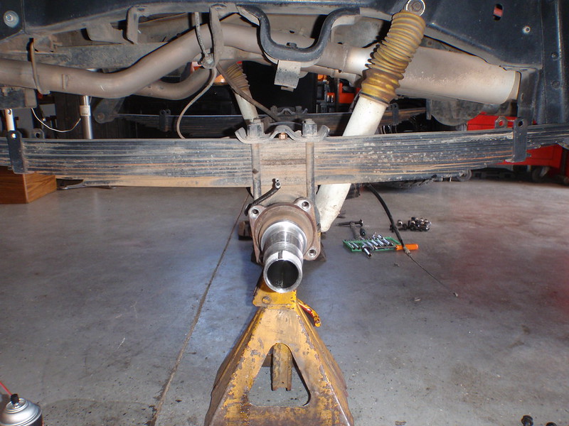

The big 13” drums stick out much further behind the wheel. They land about 1" closer to the spring plate.

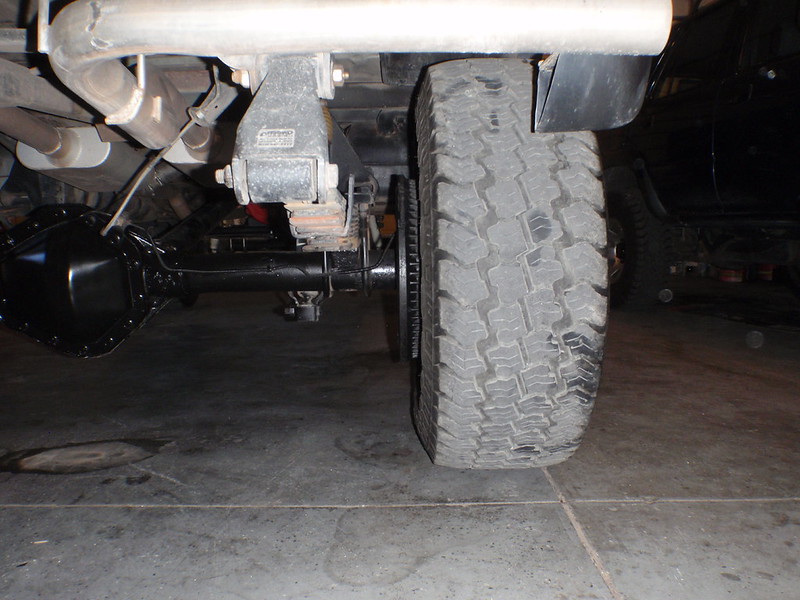

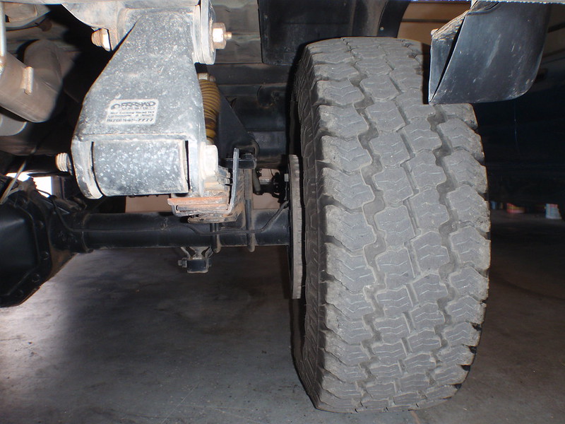

Rear view of the 11’s before tear down
