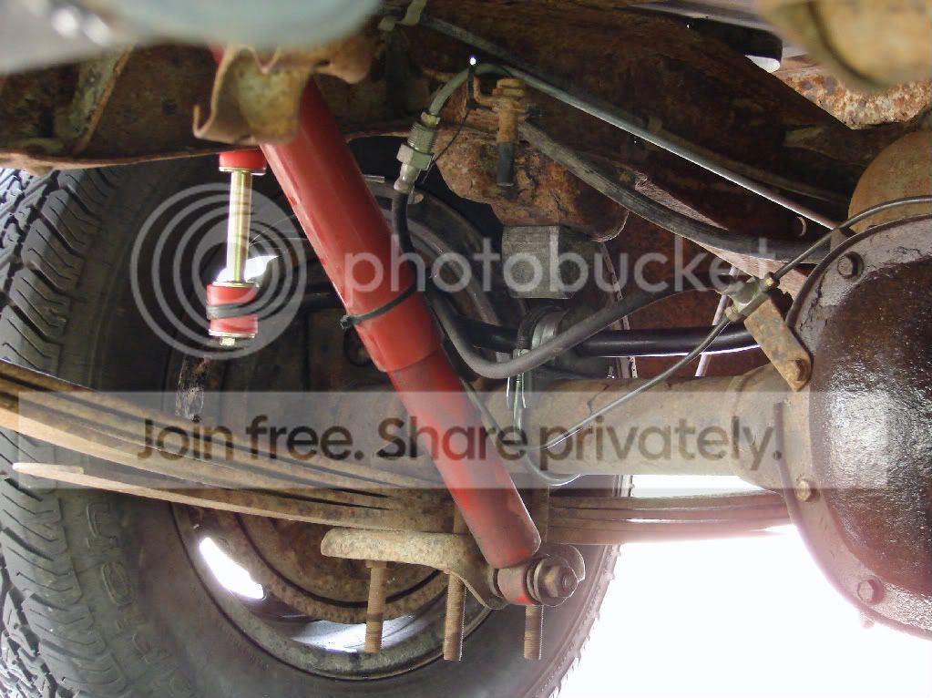

Well i ended up just getting these for my fox shocks.
Will run them and see if I need to go to a real frame mounted bumpstop. Really would like to do air bumps but not sure how to mount them when running leaf springs.
