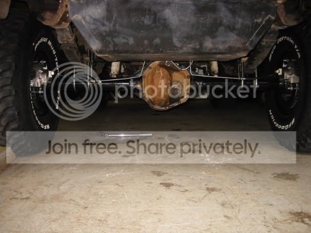

i got front lines, this is just a quick set up held on with zip ties till i have time to rebend lines and make brackets
