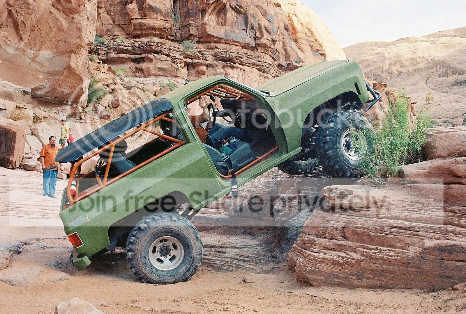

My rear axle is about 5 inches back. My fenders had been but to fit 38's with a 4" lift. It how has 42's & I just opened up the fender towards the rear. This a pretty old pic. My front axle was still in the stock location. I also stretched my rear wheel tubs by cutting up two sets & making one long set.
I like that look Boz, thats more like what I'm going after, except keeping the fang in the rear, and extending the opening with a factory look to it.

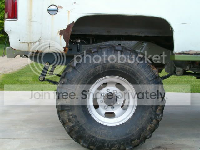

this is what I did, using DIY4X shackle flip and new 3/4t springs from Dayton Spring, and removed 2-3 heavier leaves.
This is what I did to mine....
end result....my bottoms of the fenders were rotted, so off they went....

I think the bumper hits before the shackle does....from this angle it looks to be the case, I'll check the shackles for rash though!
