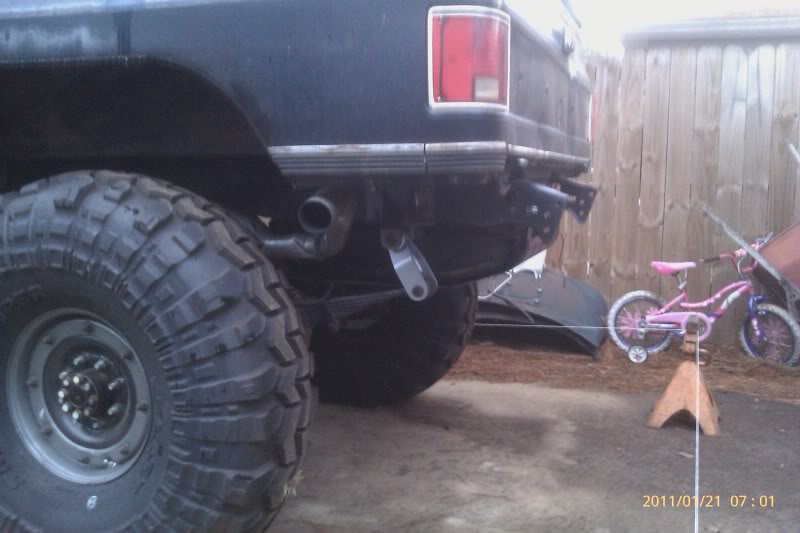

@anwat got a full pic of yours at rest showing the shackle angle? This is an old pic of mine but you can see the shackle angle (56" springs, 2.5" shackle flips bolted in the stock holes but swapped sides so the offset is rearward and 6" shackle), I don't know if the angle is perfect but it works well with no interference with the spring.
