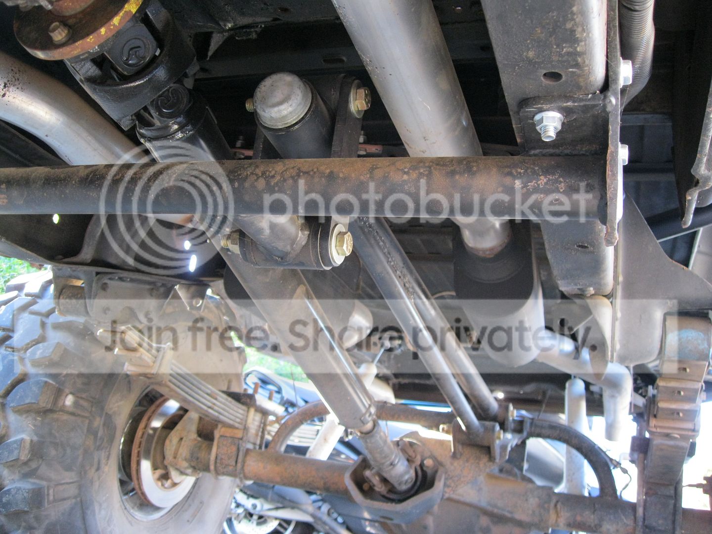

A rear traction bar is one of the best things you can do with a leaf sprung rig. Mine has REALLY helped me out over the past couple years, especially in the sand.
Avery does your design articulate as well?
It looks stout!
Averys has all the things needed.
You need it to pivot, his does, you need it attached to the frame with a shackle or something that can move back and forth, and attached to the axle at 2 points.
I prefer the shackle pointing upwards but he does sand so I am sure he is well acquainted with axle hop and how well his traction bar works.
Any of the examples above would work, I will be building one for Horton in the rear that is pretty much exactly like Averys except my traction bar will be at the top of the shackle and the frame mount will be below it.
It looks stout!
It is, I've found some pretty good sized dings in the bottom of it from dropping the back end of the truck off a rock on it and it's just fine. It articulates fine for what I'm running out back. It has a Ballistic Fab joint I bought years ago before they were a company not worth supporting.
I imagine yours is home made?

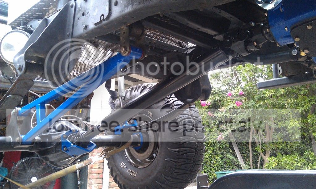

sorry for being off topic here, but avery what kind of rear axle is that? with the double joint at the top?
The axle is just a built 14ff, the drive shaft is a cv shaft so I don't have any vibes. Go look/post in my build thread if you want more info so we don't clutter up this thread.:thumb:
