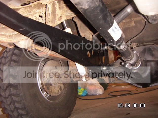

Any traction bars out there for trucks with a 12b? Or should I just wait until I go 14b?

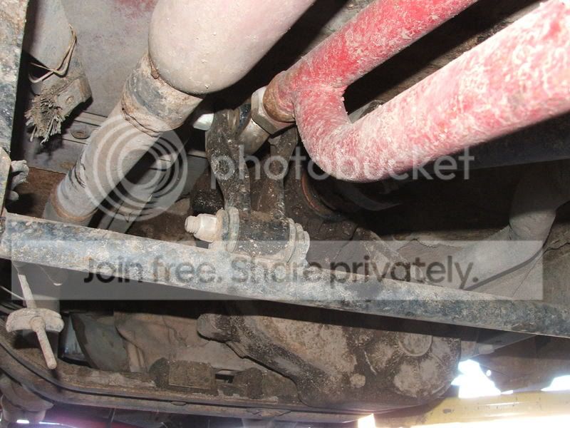

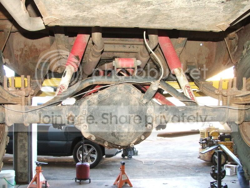

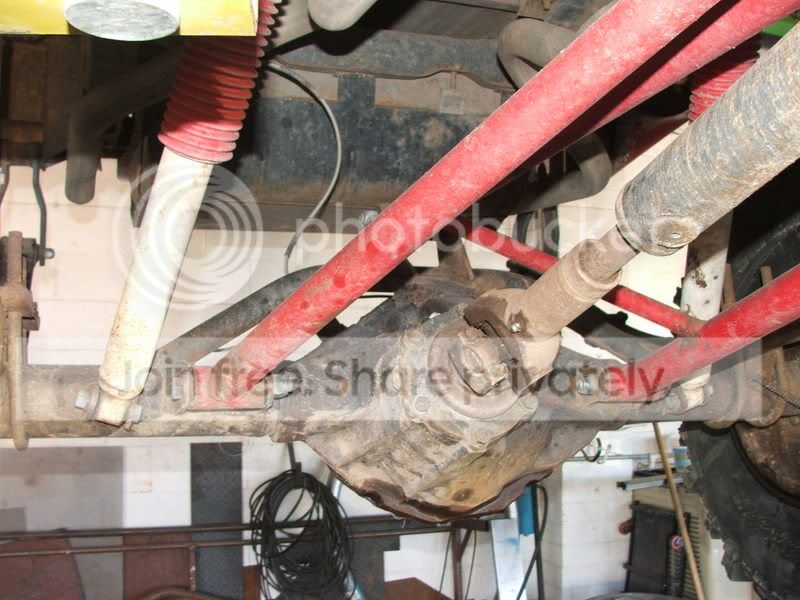

I knew some guys here in Colorado that ran similar setups successfully.I had horrible axle wrap issues and even killed a few drive shafts until I built my rear traction bar
Also, it's standard practice to weld the axle tubes to the pumpkin while doing this, to avoid turning a tube.
Has everyone else here who has a traction bar done this?

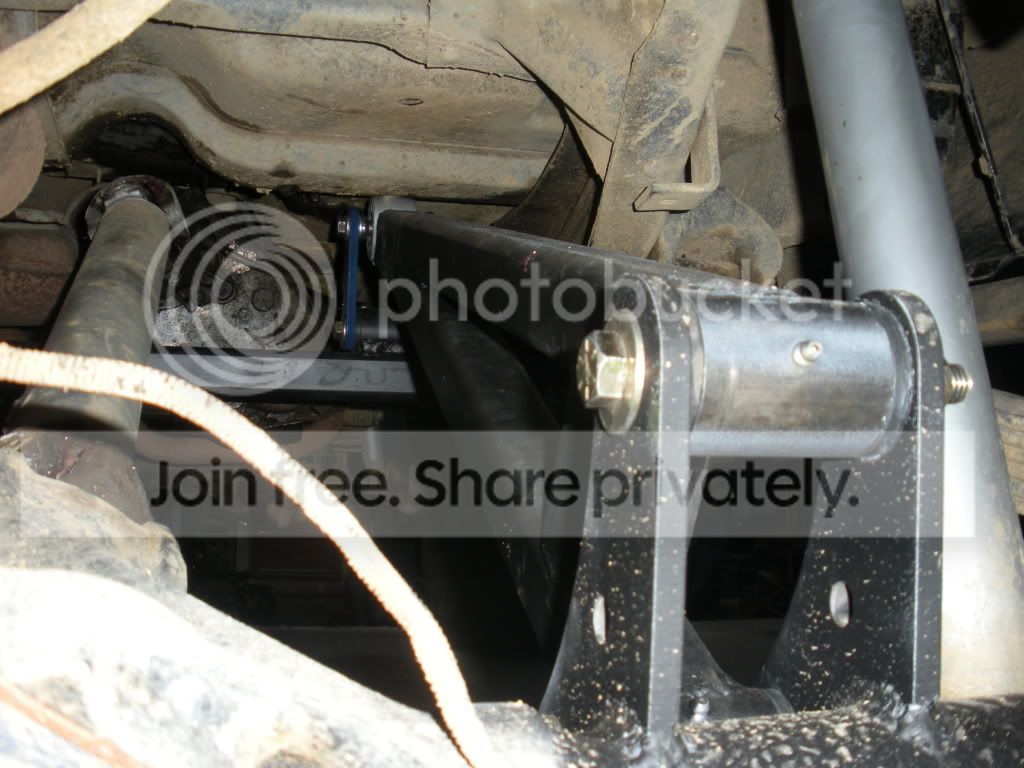

I have noticed there is a LOT of antisquat in my design. If the tires have traction it will push the rear suspension up under power!![]()
Mine too.![]()
That's not anti squat. It's on the fly frame clearance adjustment.![]()
