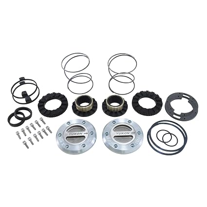

This was the kind of input I was looking for...the pros and cons of 35-spline outer stub axles on a light duty wheeling application. The 35-spline 4340 outer stub axles do not cost a whole lot more than the 30-spline 4340 outer stub axles at U.S. Standard Gear, but the major price increase in 35-spline stub axles is the locking hubs. I looked at some of the cheaper 35-spline locking hubs from Warn and G2, and there where a number of bad stories on how those where just 30-spline locking hubs turned into 35-spline locking hubs. Those hubs had a very thin locking sun gears on them that would crack under the increased load put on them by a 35-spline stub axle. Yukon (Hardcore Locking Hubs) has one of the few locking hub kits that can stand up to 35-spline stub axles. Those add about $325.00 to the build. The cheaper Warns and G2 locking hubs are about half the price at $150.

These are the more expensive Yukon Hardcore Locking hubs
