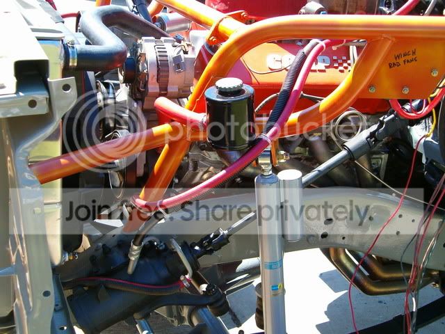

Correct me if im wrong, but isnt it your basic P/S pump, but instead of that twist lid, its some sort of fitting with a hose, that runs up to the bottom of the rezzy. I have been wanting to do this, for ease of checking P/S fluid and a bit more cooling and such.
These pieces are from a 6.2 blazer..
Yeah, I'm wanting the res in the last pic. The one with the cap. I'm going to look at the yard tomorrow and see what I an find. If not, anybody know if one can be picked up at the local parts house?

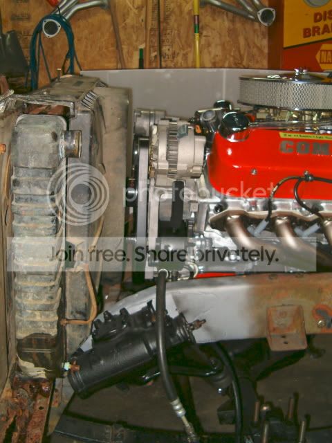

My resevoir is similar to Zimmer's but it's from a '83 454 and the nipple is on the bottom. I'm going to mate it to a typical tear drop pump using the Chrysler "boot" and a short hose. The mounting location may change as I'm not real happy with it.
John, did you ever end up changing this? Im having fabricators block on where to mount mine except mine came off a newer want and mounts from the top.
No, no changes yet. I really want to come off of the back of the alt and alt bracket but just haven't messed with it yet. Too many other irons in that fire. :doah:
Edit: I thought about mounting I to the should as that would be real simple on that reservoir but that would lower it about 6" so it would be real close to being level with the top of the pump.
It's hard for me to tell because my fender liners aren't in but I think they'd be too low to mount the reservoir. The fender itself might work but you'll end up with a hose stretching across that area which would seem like it'd be in the way while working on it.
