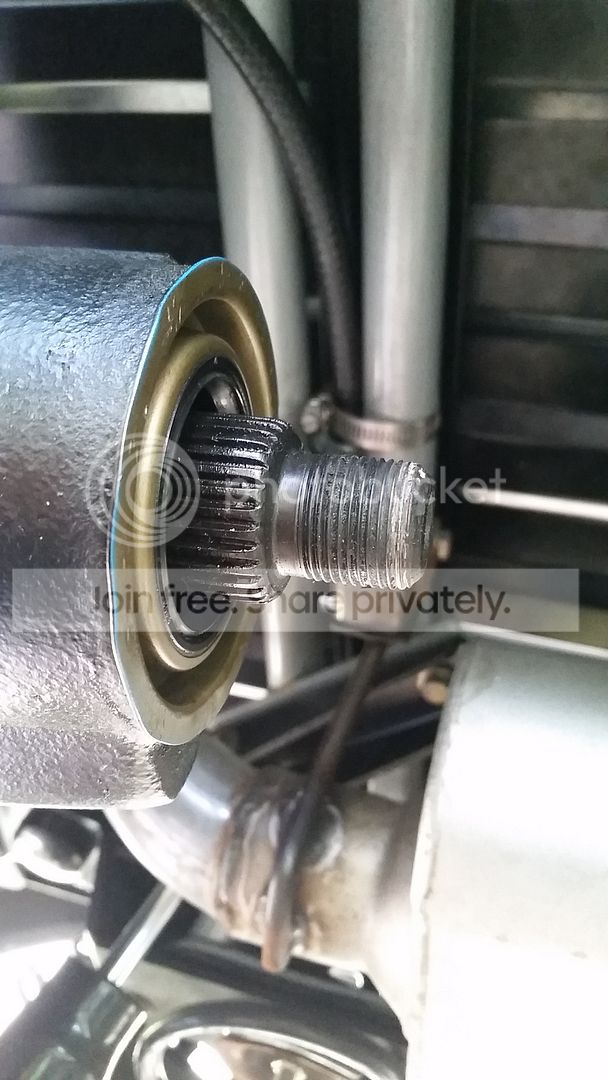

Looking at the picture, the pin looks like it needs to come out on the side of the bolt. Just wondering, before I strike it, which way in needs to be hammered out.

Pin CAN come out either way. You should be able to push it with your finger but you could tap it up a little to start it, then rotate the carrier around and pull it out. Try not to spin the carrier without the pin installed as you will dislodge thrust washers. Push each axle inboard to free the c-clips then slide them out. Piece of cake.
