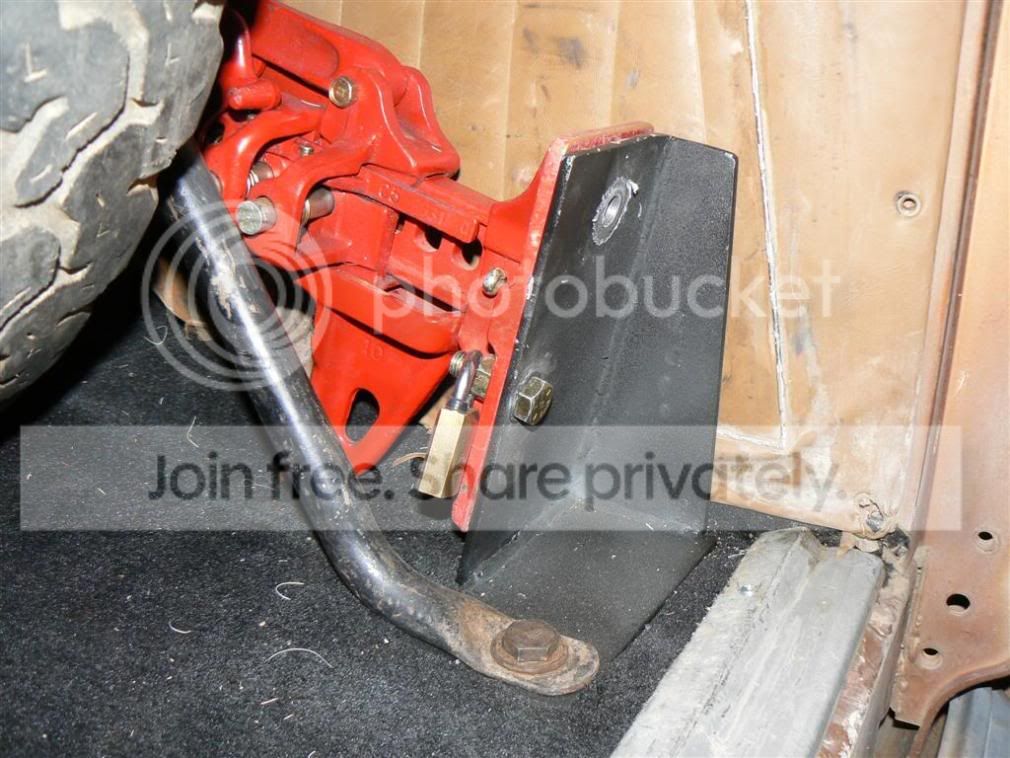

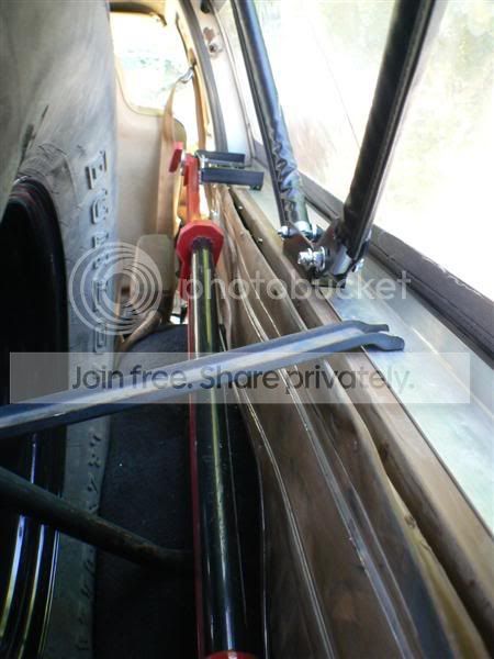

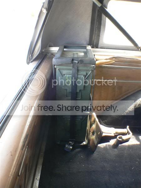

I built brackets for my hi-lift. Bolts to the spare tire carrier and to a frame that uses the top bolts. I also made a rack for my two ammo cans. One is first aide/survival stuff and the other is recovery gear.

IVe got my hilift mounted on my rear tire carrier, but I like that idea you had/did. Its out of the way and looks easy to get to. Nice.
