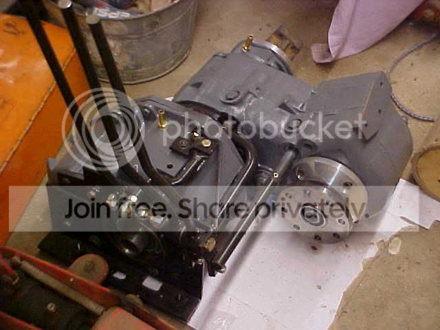

I went the way of a doubler. Chevy 203 gear box behind my th350 with a Ford 205 t-case behind the 203.
I believe you can use a newer chevy tcase also :confused: . But it needs to be drivers side drop what ever it is and it needs to be able to mate to your trans.

Yep, you can use an NP241 Drivers drop transfercase. It'll bolt up in place of a 208 provided you have the right spline count. Not sure what all spline counts they come with. For sure 32 spline in the one tons. Maybe a 27 spline as well. Of course theres always the small things that have to be changed as well like, shifter mods or switch and all the other details.
Forgot about the little things... :wink1:

If your really interested in doing this PM me. I have a NP241 drivers drop that I was going to use in mine. It's 32 spline. Complete with factory shifter.
