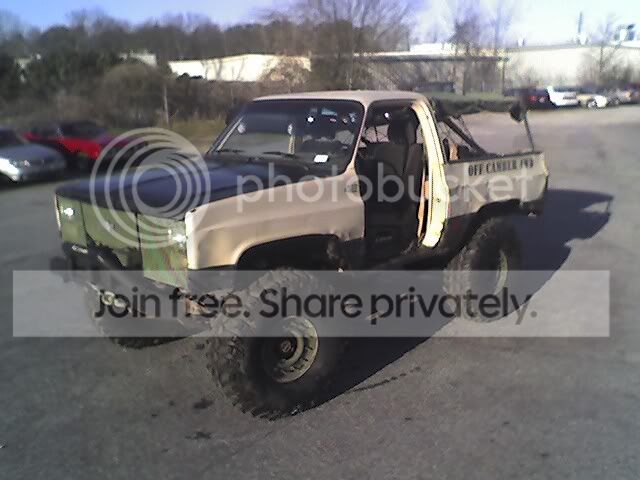

this is my truck
this is my truck with the shackle flip and johnny joint (thanks ryan)
any questions?
seriously, the shackle flip and moving the front spring hangers forwards with longer shackles are the two things that gave me the most flex for the money. the one thing I have left to do that will get me alot more flex out of the front is longer shocks and extended towers... I have them sitting on a shelf waiting to be put on. I just havent done it yet because I havent put crossover steering on it bc Im about to get a 60...
as to the revolvers, they suck on jeeps and they would prolly suck worse on a fullsize rig
