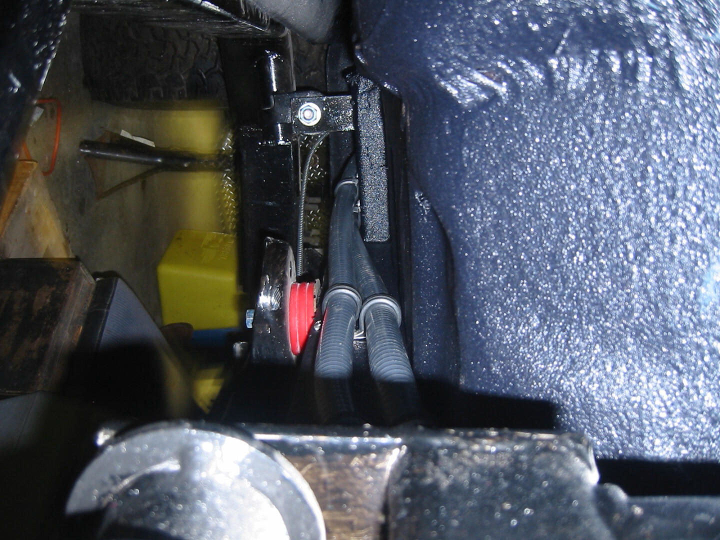

I ran mine underneath the vehicle and then back up and in where it was needed.
Of course, it wasa bit easier for me as I re-wired the truck completely from scratch anyway.
The reason some of it is in weathertight conduit is some of it is stereo RCA cables, not rated for outside duty, so I wanted to protect them.

Quality install man, nice work. If you have to access things is it a problem?
I plan on running my wireing as high as possible other then where it has to be low in the truck. I will use a similar method as above where necassary.
If I run mine as planned I'll use the hard conduit and run it down the center and across the front of the ledge where the back seat sits, then spray it to match with liner. I'd stay away from the black split loom stuff, it's really just for looks from what I can tell. No real protection what so ever.
