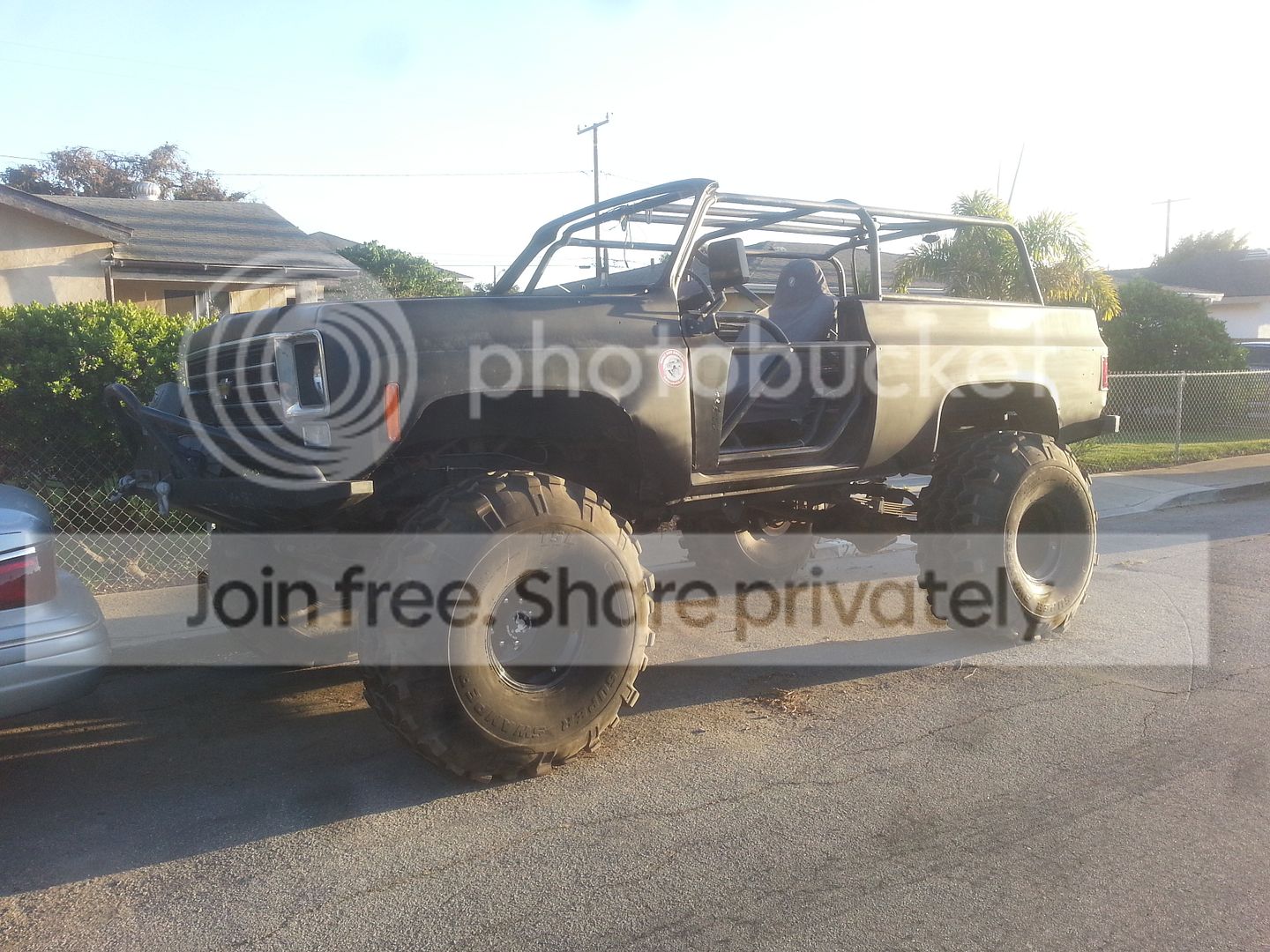

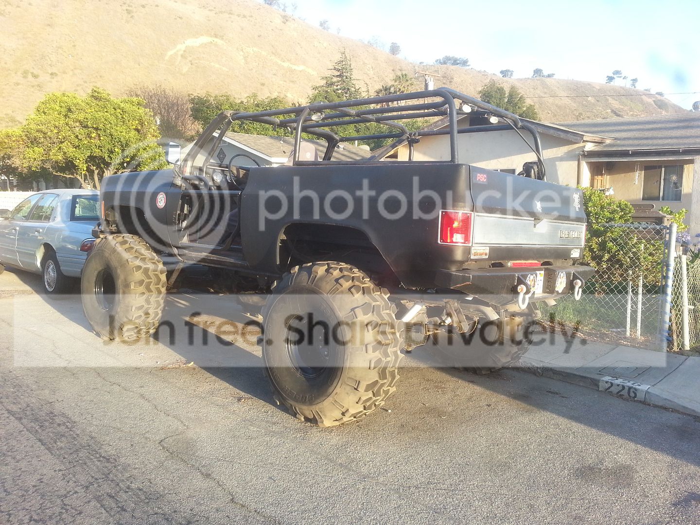

I have 6" lift ORD custom springs with axle moved 4" forward, 3" body lift, and 44's. Lots of cutting and the tires still chew on the firewall when flexed hard.
Old pics....not that pretty anymore lol
