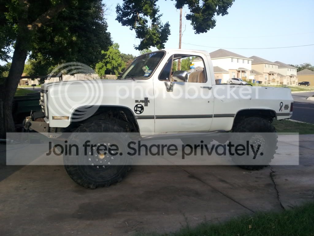

This is how I like mine. 4" and 39s which were 37.5 ish. Axle was moved forward a little. Two inches maybe? Clearance for days.
