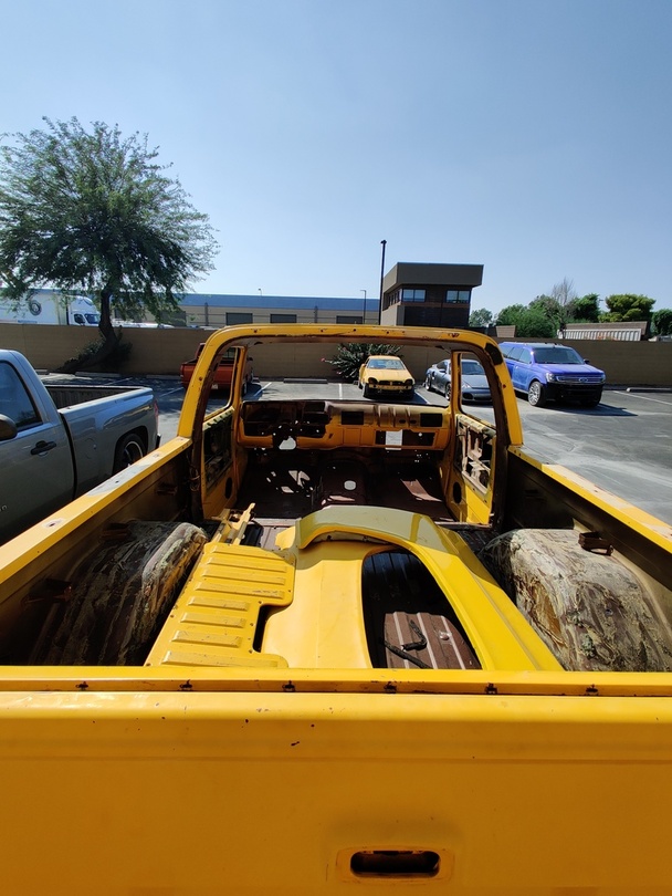

Well, I decided to cart the Blazer off to get blasted. It's sitting at the shop now.

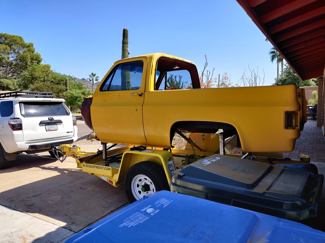

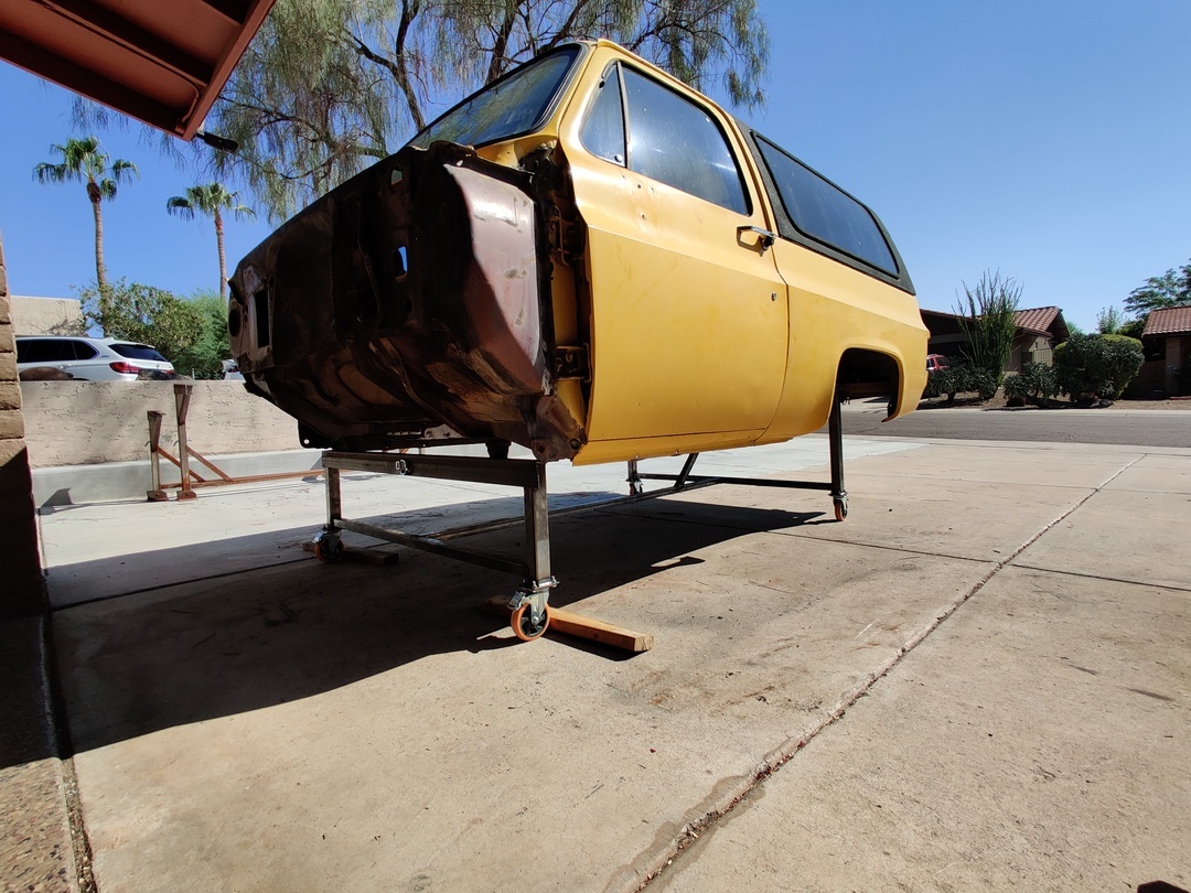

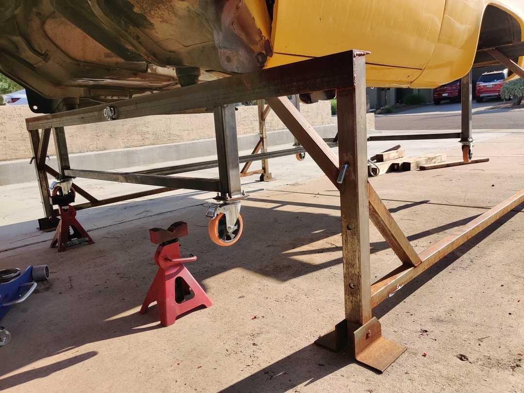

At 8 feet wide, the giant cart the body has been sitting on wouldn't fit on any trailer I could find, so I spent the weekend modifying it. I ended up welding a narrower, shorter cart inside the existing one, supported it with jackstands, then cut off the outer legs from the old cart, and carefully lowered it down.
I removed the top and tailgate and winched it up onto a tilt-bed trailer I rented.

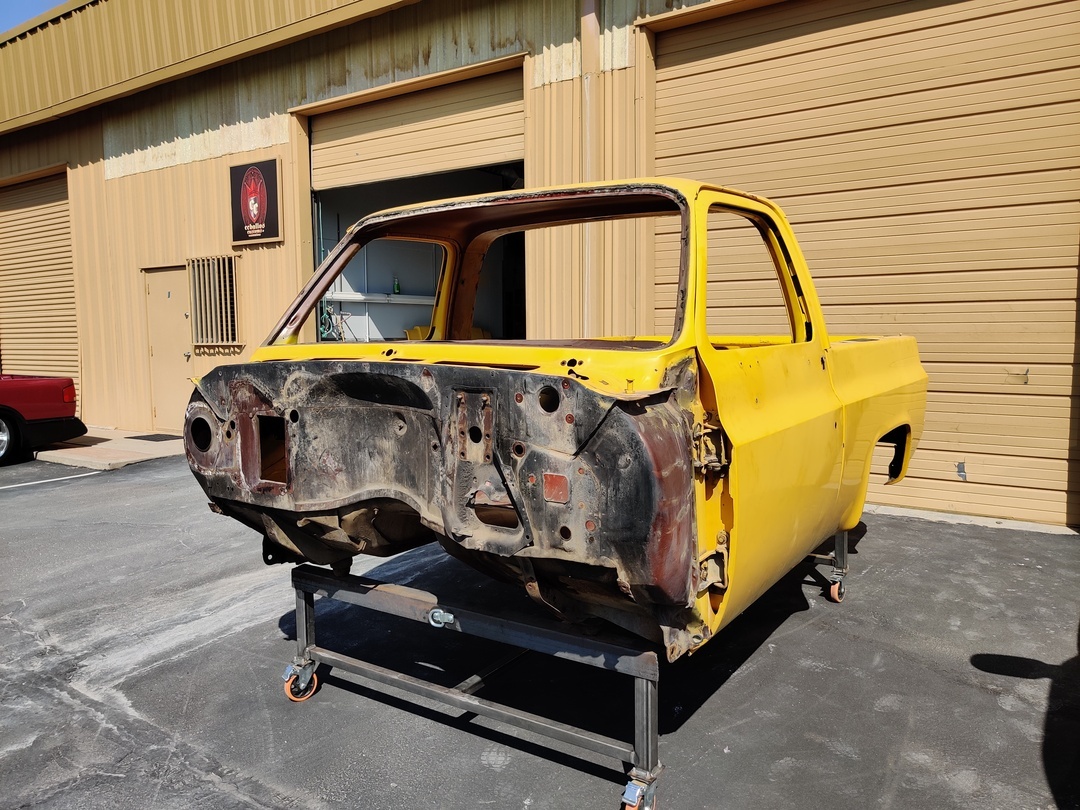

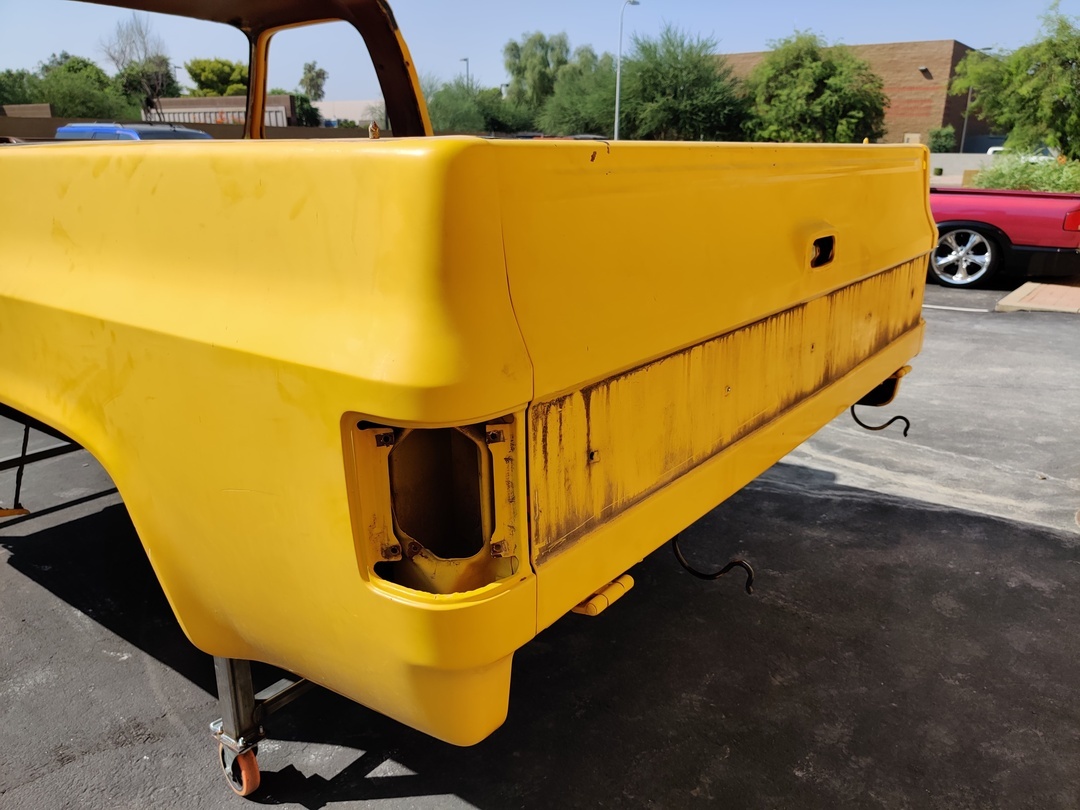

Here it sits with all glass removed, waiting to get blasted.
Once blasted I'll have a better idea of what rust repair needs to be done, but it looks to be pretty solid apart from a few small sections in the floor, rockers, kick-panels, and fenders.
Hoping to get this thing in primer soon! I'd be happy if I can get the body back on the chassis, painted, and started on reassembly by the end of the year. We shall see!
looks really solid, even the rockers don't look bad. must be nice working on an arizona truck. if you don't mind my asking, what are they charging to media blast it and what media are they using?

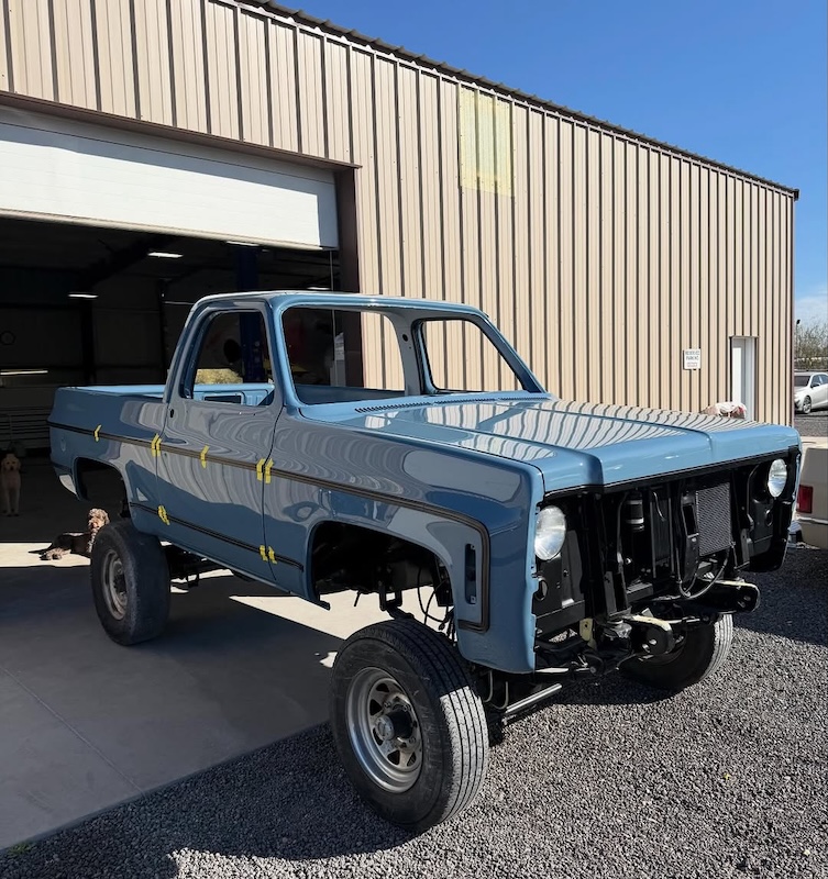

Daaaaaamn it's been years since I've posted here. Was really hoping I'd been done by now, but at least things are moving along. Here's where it sits currently, I'll try post a more detailed update soon!
No tunnel work required, the body cleared everything just fine with no modifications.
Hot damn. So much better than yellow
