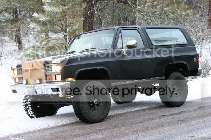

cut about 4 or 5 inches of the body out, welded in the 2x4 metal tubing, mostly done by ck5er supersize75k5. not quite all finished up yet - still gotta trim them down so there's no overhang in the wheel wells and then also weld caps on the ends.
don't have many closeups of them all done - sorry, gotta look behind me to see it a bit better...
this requires modifying the doors, i.e. cutting the bottoms off. unfortunately, what happens is that when it rains, the water seeps down into the door thru where the window goes down, and puddles out into the truck. so, i intend to weld in a base plate, say about 3 or 4 inches high at the bottom of the door opening, kind of like the lips that jeeps have. then i'll drill some holes so the rain can run out. should work and look pretty slick.
