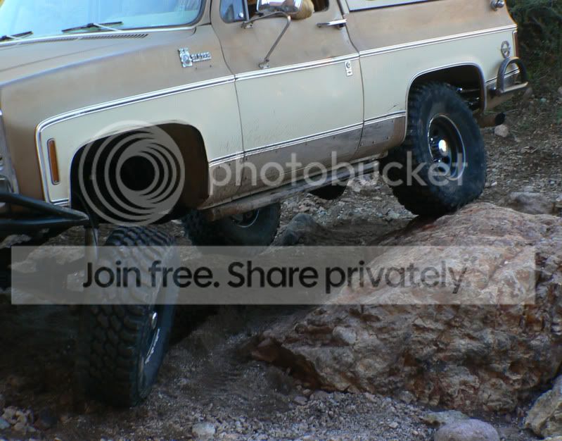

Mine are DPI and they are not tied to the frame. Not the best pick. The rig came down hard on a rock after I dropped off a ledge. The slider did its job.
These are the ones I have http://www.dpalms.com/dpi/images/RockWhores.htm. I picked them up from the classified section.

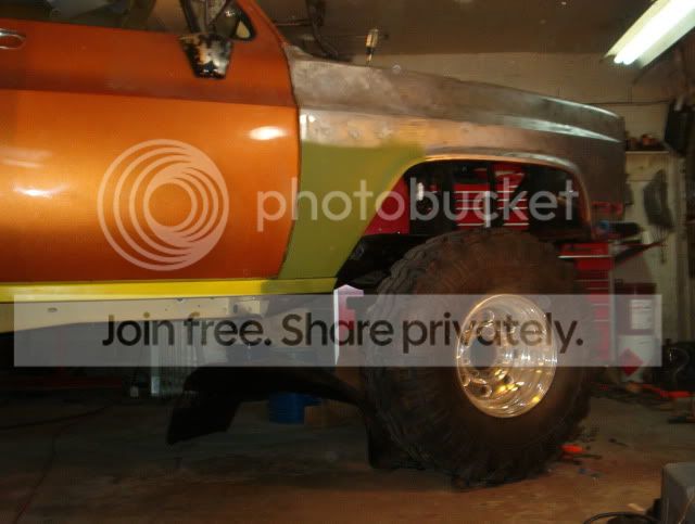

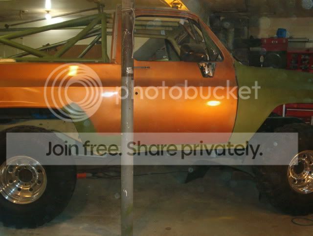

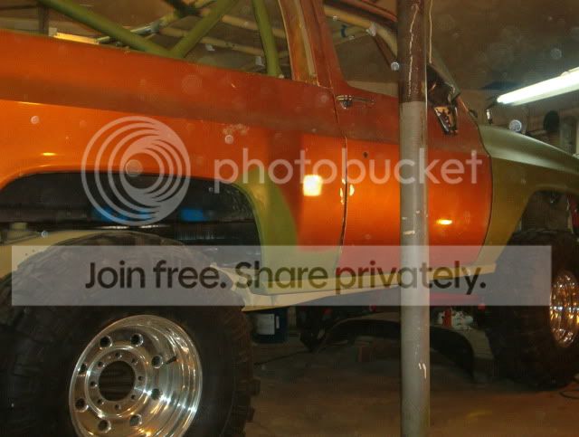

I'm running the integrated 2" x 4" method.......
** whoring complete**
That looks awesome! Do you have pictures of underneath on how you tied and welded it all in. thank you guys for the help and ideas all these rock!
easy ones first... no, i didn't cut the doors, the sliders run right underneath them....
the green is zinc chromate.... the best raw metal, self-etching primer you can run other than the 2 part version of the same....
I'll have to hunt ya down some underside pics tonight, or I'll snap some.... I'm on lunch right now... to be fair, and forewarned, my setup is FAR FAR from stock.. the sliders are hard mounted to my custom cab support system and floor, so it's a far cry different than putting these in a stock app...
