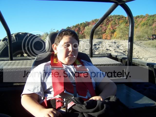

My nefew was in a roll over this fall in an adult sized PRP seat while wearing the fourpoint harness and he did just fine. He's 6.

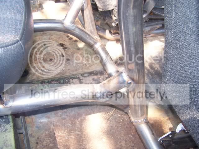

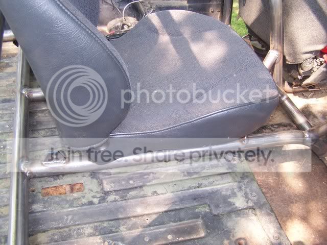

I am using a set of junkyard seats that are welded to tabs that are welded to the cage.I have five point's as well.
95ish Cavalier maybe a little later years as well.I just went and picked three out that was about the same and didnt have dried blood on em.If you look at the pics youll notice they dont exactly match but close enough for a trail rig.I wanted the nice suspension seats but by the time I bought two reg seats and one of the big girl seats for myself I was going to have more in seats than the rollcage.
