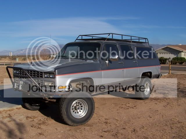

Here is my rack. It's basically round tubing with a expanded metal floor. Sorry for the crappy picture, but it's all I have right now.
Hmm it worked for me. They are really hard to see until you click on them. They are right under the titles: Top View, Side View, Front/Rear View.

hey, jeff, got any pics of how you attached the rack to the roof?
Jason, wish I did but a lot of the old burb pics were on my old hard drive that crashed and was unrecoverable :doah: But all I did with mine was hard mounted it with IIRC 4 posts per side and 2 bolts through the roof per posts. Used a homeade rubber gasket under all the mounting feet. Never did leak once in the time that I owned it.
