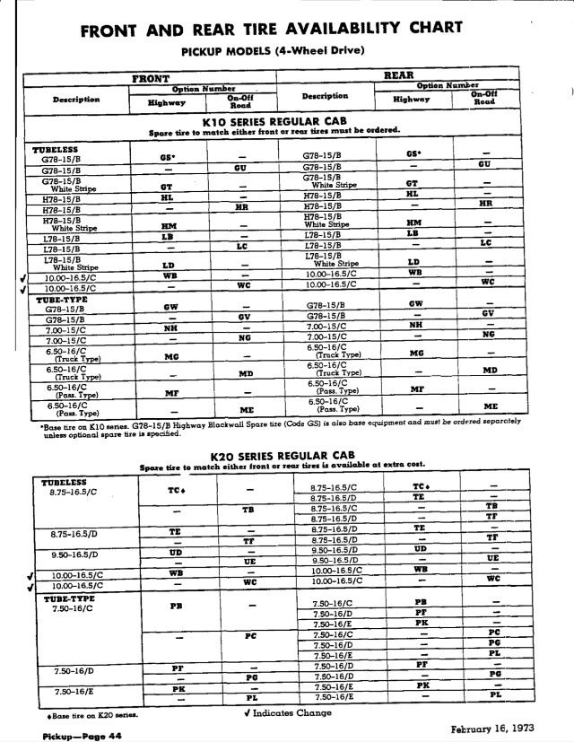

In the early 70's you could get 16.5" wheels stock on half tons and K5's.

Just went and checked. In 1982, 16.5" wheels were standard on 3/4 and 1 ton trucks, with a few choices of optional 16" tires. In 1983, 16" wheels became standard on 3/4 and 1 ton trucks, and there were no 16.5" tire options.
Martin
Yep, in 1973 you could get 15", 16" or 16.5" tires from the factory on a K10. A K20 had the option of 16" or 16.5" tires. There was no K30 yet.
