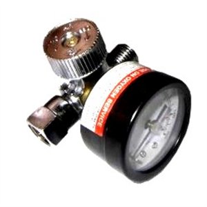

I still gotta get a regulator or something because thaere is just a big 1/2 inch hole on the right side of it...debating whether or not to use leader hose and then to a regulator/air filter attched to the wall, or attach the regulator straight to the 1/2 inch opening?
I did not win that dessicant dryer on eBay....
I think I would go with hose to the wall.
If you start doing dryers, they are going to mount on the wall.
And regulators like dry air better than wet. So, you can mount the regulator after the dryers when you get some.
I've never run system regulators at home, I regulate everything at the tools when necessary..
1/4 turns for many tools...
or for spray guns, variables..
So...out of the compressor and straight into a water seperator, then a dryer?

I fired up the compressor today...man that thing is quiet...the inline sander is 3 times as loud as it is...
I opened the water drain valave and this yellow sludge that looks like baby poop plopped out...then some dirty water...
I guess I am not understandin how a regulator works...when I dial it to 90 and put the inline sander it goes to zero real quick...if I dial it up to 120 it drops down to 90psi while I am pulling the trigger...when I stop it goes back up.
Will the initial 120 blow the inline sander up? :dunno:
it'll take as much air as you can throw at it....
