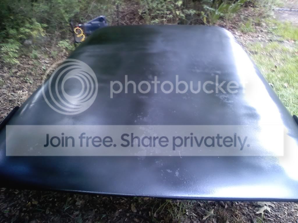

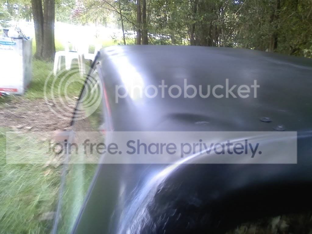

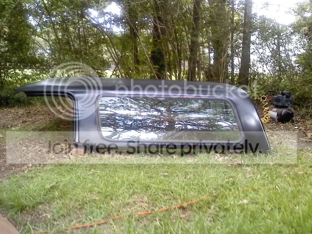

Painted the hardtop black yesterday. Thinned out the Rustoleum about 15% with acetone, came out nice with no runs, but it wasn't too thick. Pics:

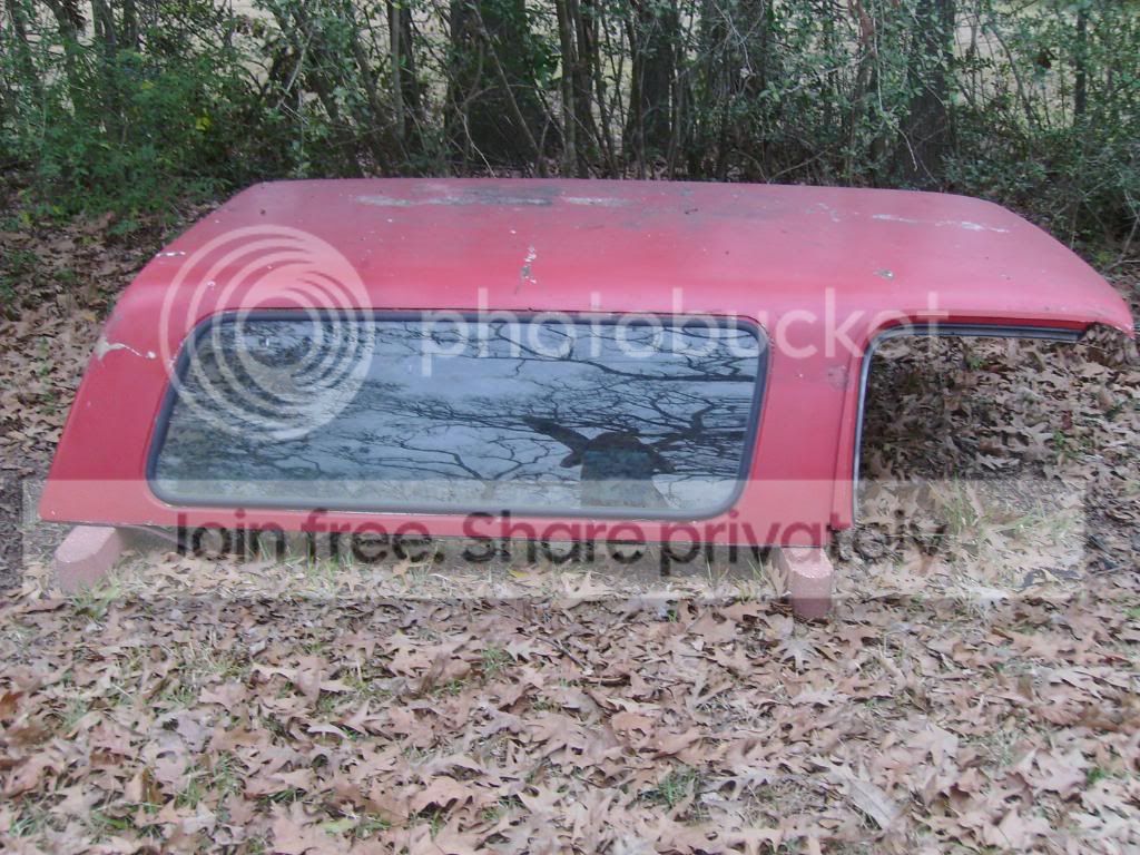

Before:
After:
It's definitely what some guys would refer to as a "20-footer" paint job, but I ain't going for anything near show/decent quality, i just wanted something I could easily touch up if needed.

This top had spots where the gelcoat/paint was gone and was mildewing...the back corners have my "strength and function are way more important than looks" fiberglass repairs. Having it all one color is a vast improvement and as I said, I just needed to get it painted. As for removing the windows...I'm lazy and pretty good with a roll of blue painters tape.

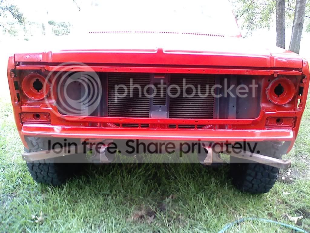

Finished pulling everything tonight, and sanded the body. Lots of sanding. Cleaned it all up with Marine Clean. I'll move it in the morning and rinse it off, let it dry, mask it off. That will probably use up all of my time before work, so paint will either come tomorrow night or Wednesday morning.

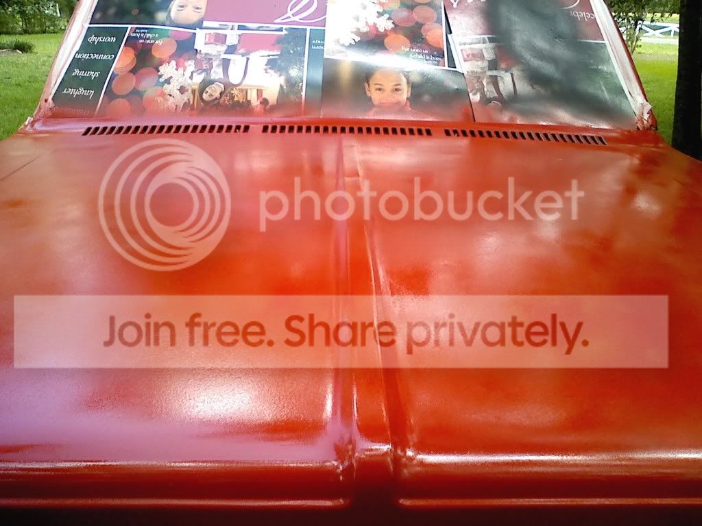

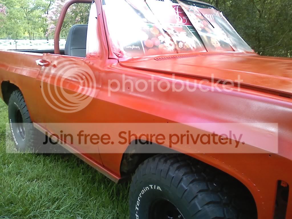

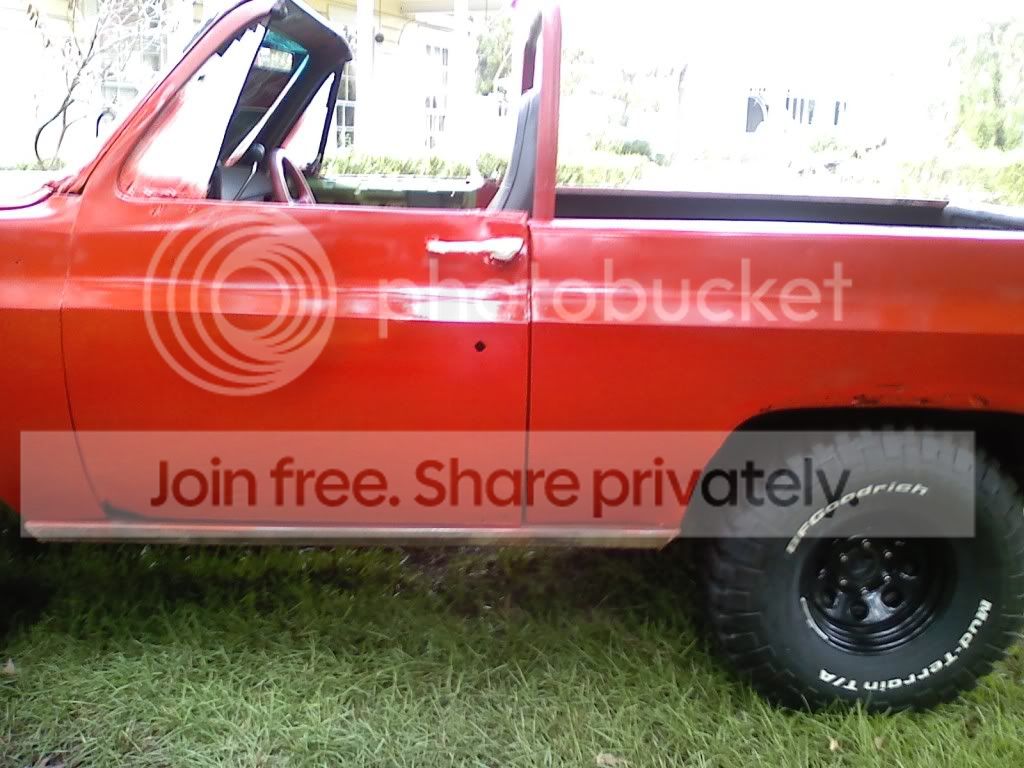

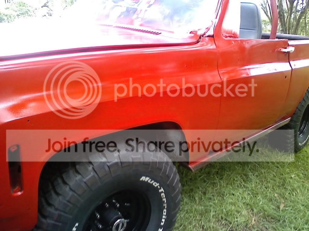

Got out early this morning and masked off the truck. Had enough time so i went ahead and sprayed it. I don't know whether I'll do a second coat or not, to be honest I don't want to. Anyways here's the before and after.
Before:
After:
Not fantastic, but for the time/money put into it....it is fine by me.:D Gonna put it back together tonight, and hopefully be driving it tomorrow.
Let 'er rip guys, what do you think? Another coat? Leave it and use the rattlecan version of the exact paint to touch it up if needed? I'm crazy and should have just left it alone until a real job could be done?:wink1::p:

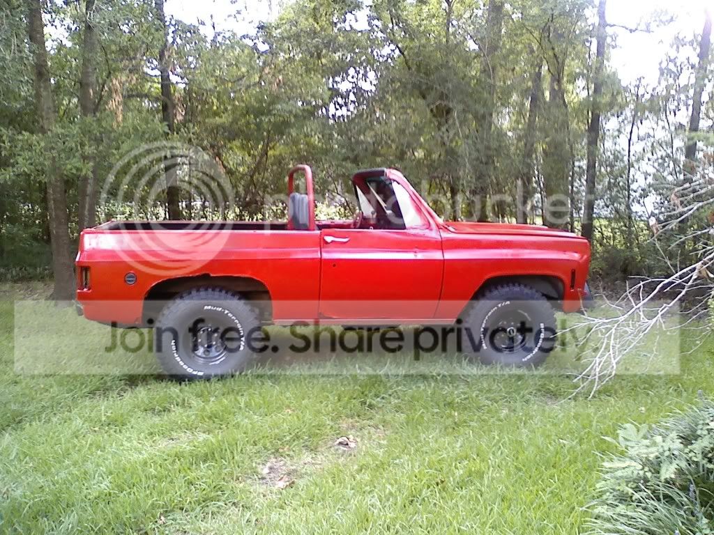

Hey man as long as your happy with it, it looks great one color.
Maybe do the lower rocker pannels black to help tie the top in.... It will help hide the rust as well.
SOMETHING LIKE THIS

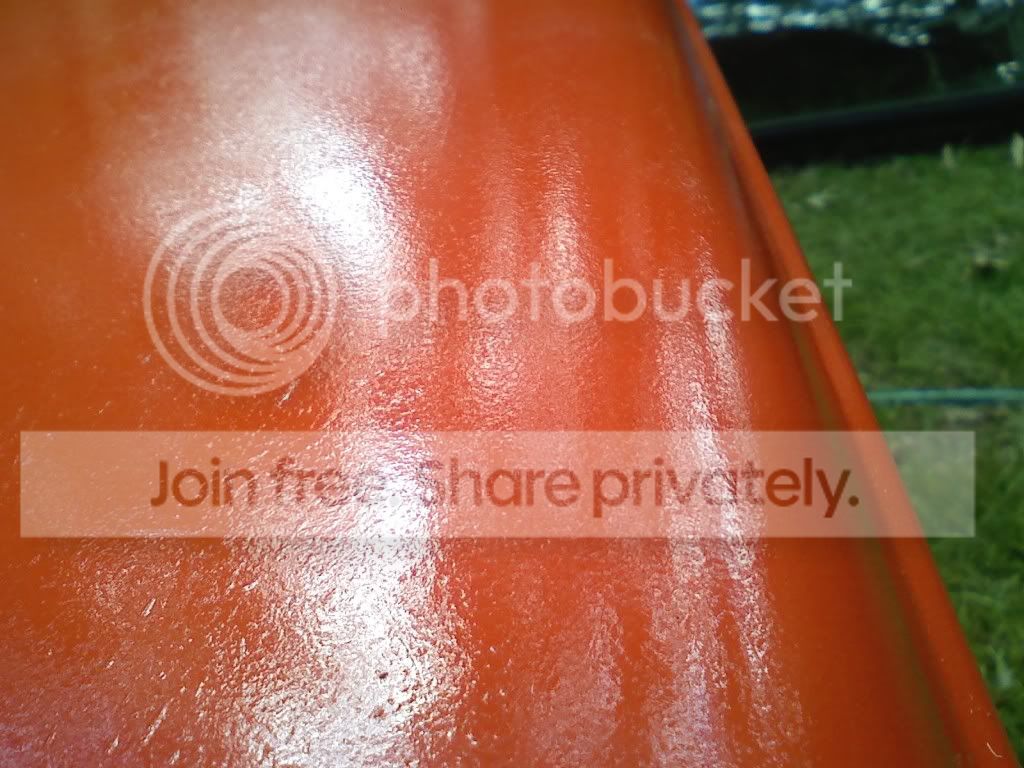

Are you goin to try to get rid of the orange peel look? It looks good and would probably look even better without that
I have the stuff to wetsand it....is that the way to go? I don't have a lot of time to put man hours into this so if it's a tedious thing, then the orange peel will remain haha
Thanks. I will be painting the sliders black, and it's possible I could do some type of lower accent....i don't know, i'll look at it tonight.
Edit: I will say that the drivers side rear fender will be getting cut out some more(like the pass side), i just haven't gotten around to it.
I photohacked a pic to show you what I mean.
as far as the orange peel I think you can use a high speed buffer to polish it out but being its only one coat of paint you might burn through too quick.
I dont know for sure I think it has alot to do with the kind of paint it is. So I could be wrong on the buffing.
Ah, so similar to like...colbystephen's '73, cept he used Herc i think. hmm...
I think i'll leave the orange peel. It don't bother me. And means touch ups will blend in better haha
