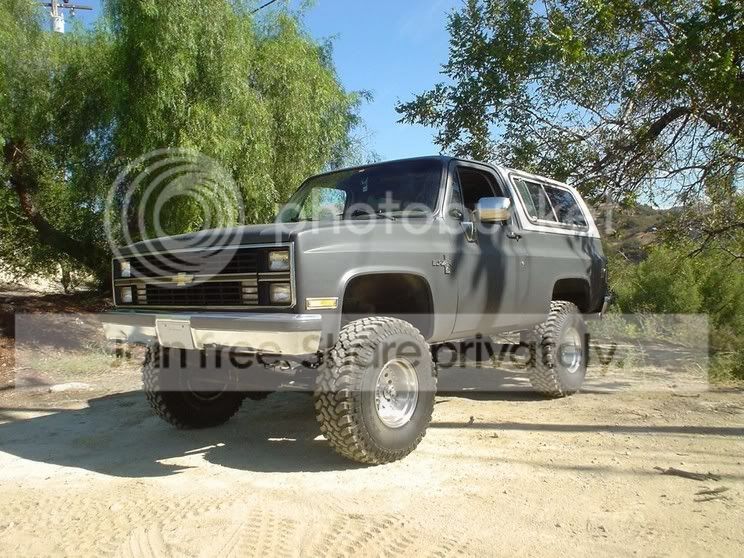

I found this rig while searching for rattle can jobs...looks awesome!Anybody have any idea what color this is? Can't tell if its a flat black or dark gray or what.
You know alot of people seem to not like this by I think that looks good for something so cheap. I think I might still spray the rustoleum on mine though.
Yeah, I'm not looking for anything too nice. Its going to be an offroad toy! You can rattle can it and if someday down the road you want to put a better paint job on it you can.

do you think that truck above is satin? looks to have a sheen to it.
Hard to tell from pix. Hell, my truck looks halfway decent in the pix I post :haha: (I don't post the closeup pix for a reason :D )

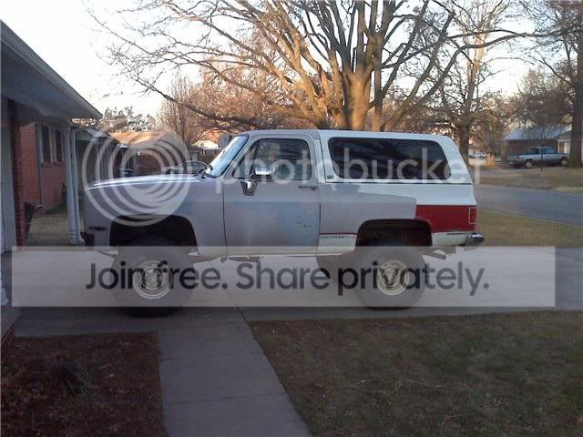

Figured I'd post a pic of my rig in its current state, as you can see it needs some help :D

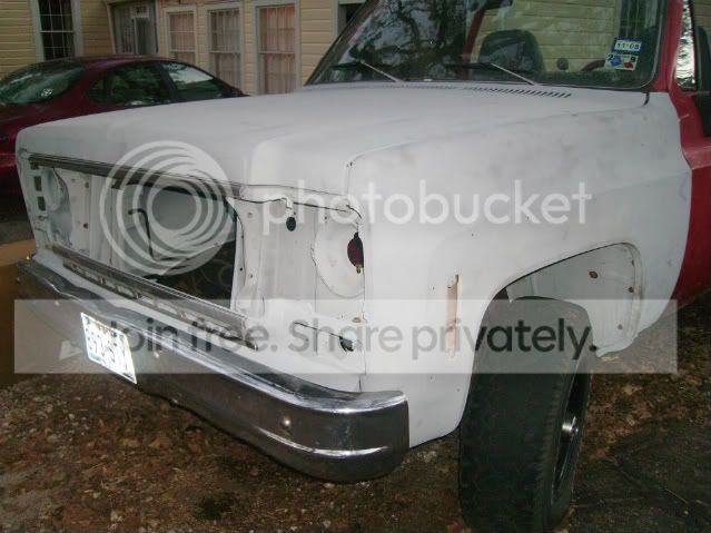

I took the front clip off my '79 donor and primed it:
I took my time with the prep, but nothing crazy, and it turned out pretty good. I plan to hit the whole truck with this when I finish the bodywork and then paint the body red and the top black. However what you've heard so far is true, the end result is based heavily on how much time you spend prepping.
