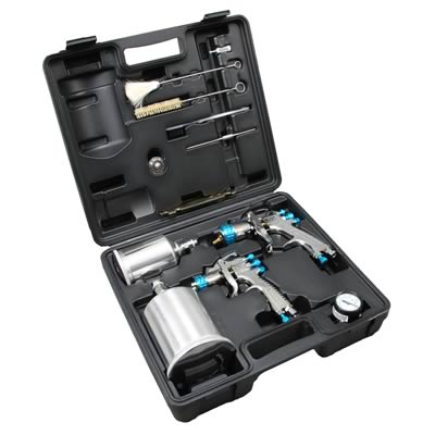

for a name brand beginner gun, i like devilbiss's starting line series... VERY economical at about $100 to 125 for the 2 gun kit..
http://www.summitracing.com/parts/DVR-802342
$130 thru Summit..
Astro Pneumatics makes a surprisingly decent beginner gravity feed for like 75 to 100 too...
