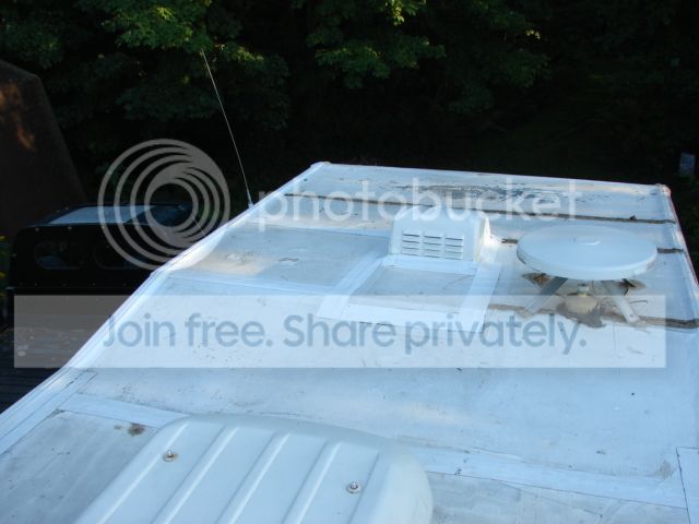

looks like the TV antenna started the leak, and someone patched some goo on it, and called it good....NOT.
then on the back I notice the painted on layer of roof sealer is peeling up and looking suspicious, so I get into that as well....boy a lot can be hiding under a little hole....reminds me of rust on chevy trucks, once you start to repair, it snowballs into a bunch of repair.

It looks save able if that one 2x4 is still good. It not that would be a royal pain to fix.
You got much money into this thing ?
From this picture, it looks like once you get the junk off the structure is solid. Is this material spongy or as solid as it looks? Does the whole roof have to be removed? What is the roof made of? How big is your trailer? Can you get a picture of the whole roof?
I always replace the screws on my RV with stainless steel ones.
I paid 2700 5 years ago....haven't had to put much into it, a few little things here and there inside...this is major for this thing.
I will marry a couple new 2x4's onto the existing one, even sandwich the old between the new ones if needed, that one on the back is pretty wasted....the roof substrate was mush, the ceiling plywood is wet, but not rotted much...it has a vinyl sheet stuck to it for the ceiling material, and it is still intact, so it will stay.
I've sprayed the cleaned up area with bleach and tomorrow will get the back cleaned up and sprayed/prepped like the front.
so first question, I need to patch in the membrane in these spots, should I butt the new up against the old, or overlap a few inches, then put some eternabond roofing tape over it...
Then recoat the whole roof with a good roofing coating?

these are the two areas (maybe 25% total roof area)
It is a 27'
The structure is good, I will use more marriage trusses to give more support to the new parts of the roof.
the existing roof is a pretty tough membrane type, stretches and is glued to the 5/16" sheathing pretty well where its dry...it is pretty hard to remove where it is glued on and dry still.
I can try to get a pic of the whole thing tomorrow. I will also get some pics of the corners....not real impressed with how they folded the siding over and stapled it then covered with a halfass wrap corner screwed on channel...
