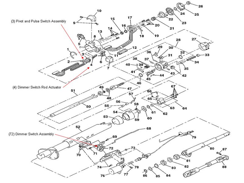

These old Saginaw tilt columns are a PITA. When I got my 89’ Burb last October it was so bad that it would hardly start (rack and rod were damaged) and the turn signals wouldn’t work. After ripping it down I found the bolts had been loose for so long that ball bearings were missing and the upper bowl had to be replaced along with the bowl itself. What a hassle. Fortunately, I had a couple spare steering columns lying around to pirate parts from.
Pblaze725 did a great write up on the early tilt columns but the later ones with the headlight dimmer in the column are a bit more complicated as there several more little intricate pieces to deal with towards the top.
Here is a diagram of the same basic column used in the later columns with the column mounted dimmer switch. This is a 1995 G-van so it has a brake interlock switch that our trucks don’t but outside of that this diagram is the same.
