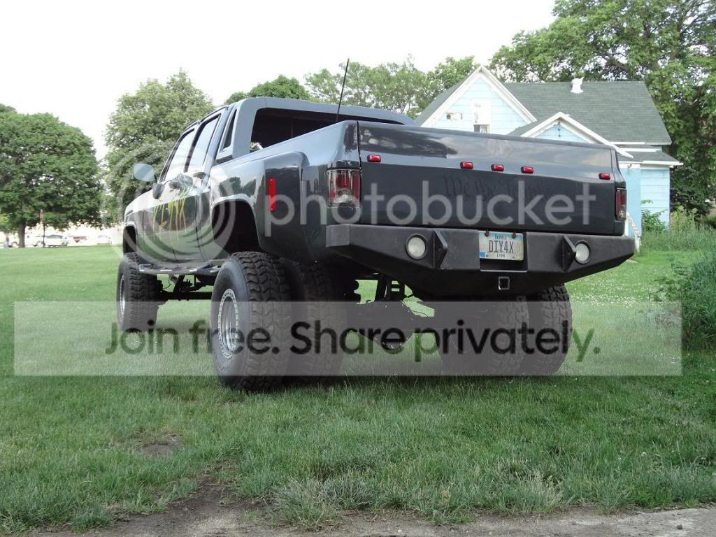

Build it and they will come....so you know you gotta have a build thread right?
yeah, basically I want to build Kert's rig with a Cummins, shortened up a bit with a tube bed.. dually on 4" with 35's... big mud flap on each corner hangin under the bed...
I want boxes like this hangin under my bed on each side..

hehe, I want to run 35's on a duallie...... actually, i just want Kert's tire set up... ;)
